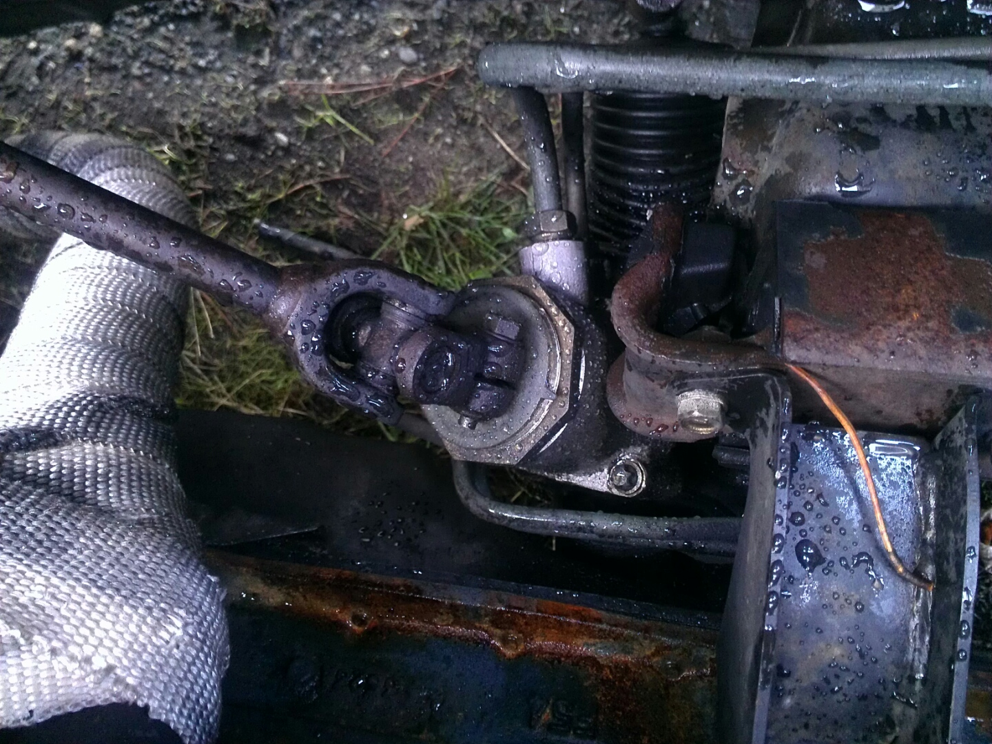

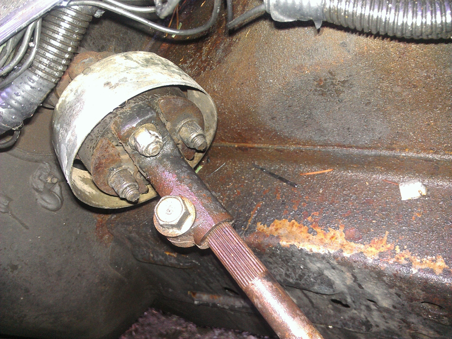

Actually, I read that thread earlier this morning. That's what got me back onto the subject.
Pics as promised.
again, the PO had apparently done an engine swap that I didn't know about untill a few months ago when I was checking the head/block numbers, wondering what else was done.

The biggest part that bugs me is that my 79' is a GL model, but I don't believe that this is an RB style steering.

Attached Thumbnails So this is bugging me...(Steering ID)-100media%24imag0195.jpg   So this is bugging me...(Steering ID)-100media%24imag0197.jpg
Old Dec 5, 2012 | 10:59 AM
Looks like a normal rack & pinion setup to me.

normal as in powered? It has a belt driven PS pump that I didn't take a pic of.
Old Dec 5, 2012 | 11:15 AM
If there are hydraulic lines going from the power steering pump to the rack... then it's a power steering rack...

Well, considering it's a 79 NA GL,and I recently found out that it had an engine swap by the PO, I was wondering what else had been done to it, and this came up when I was researching doing a turbo swap. Seeing as its a rack and pinion (thanks for confirming, btw) that's one less thing I would need to get. I'm also interested in depowering it. I don't do a whole lot of low speed maneuvers and have driven manual steering cars before without a problem. The current pump is starting to whine when I turn the wheel and looks pretty beat up. Removing it should reduce parasitic drag on the engine as well as clean up the front of the engine a bit more.
