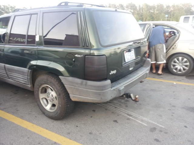

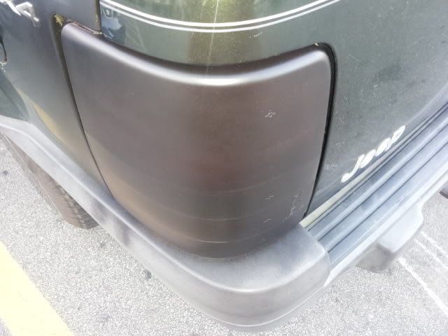

Look up a product called plastidip, typically bought at your near HomeDepot or you can grab fancier plastidip at dipyourcar.com
What I did:
Grab a can of black, mask off around your tails, you don't have to worry about overspray too much as plastidip when dried, can be peeled off...
Anyway, if your new at painting this could bea good practice for you. Spray a light coat, don't let it run, and DO NOT COLOR IT WITH THE FIRST COAT, should be about 10% transparency, first coat id just for making it stick. Then use a few more coats to your darkness, not too dark mind you.
The good bit is that if you goof it or decide you don't like it, it comes of with Zero damage to the surface, just rub and peel it off. It gives a matte finish so ether grab a can of plastidip clearcoat(supposedly works like clearcoat but peels like plastidip) or a can of regular clearcoat...
Here's a pix of my jeep, done in a walmart parking lot, zero prep or masking (this is why you should) probablyc could have done better but this was my first time
