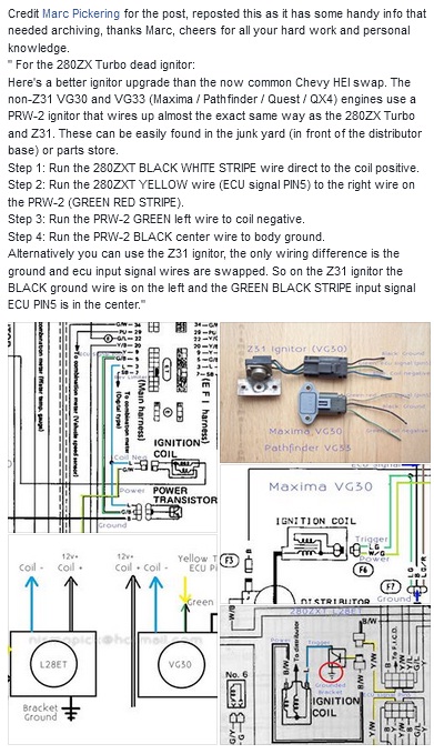

I have a 83 280zxt. has anyone ever switched to a prw-2 power transistor (X31)? Can it be done? You can't find an oe transistor, they do not make them anymore.
Thanks guys,
Old May 14, 2017 | 08:24 PM
Yup. Click. https://www.facebook.com/groups/DatsunKnowHow/permalink/1262561107089477/

thanks for the info, I looked far and wide to find some information. MANY thanks! !!!

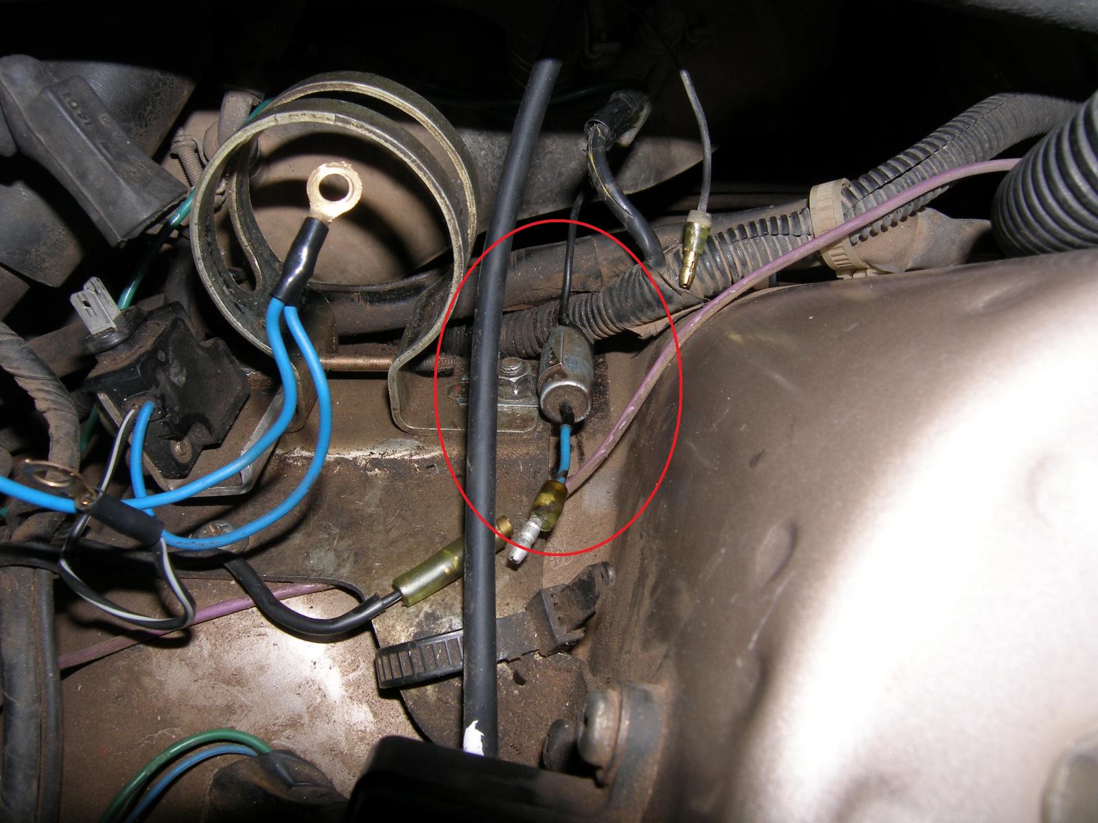

So I have followed the instructions for the prw-2 swap for my 83 l28et. this is what I am missing. The blue bullet wire from the harness. it was on the positve side of coil origially .
What do i do with it now? Thanks Nismo!

A pic would be helpful... you talking about this?

see attachment. If you see the blue female bullet wire . A blue male blullet is bundled with yellow wire and black white stripe wire coming from coil harness. The blue wire coming from harness .what do i do with it?

Ok i solved the blue bullet wire! It just spiles into the negrtive side of coil. I now have spark. I believe i may go to the tach.
