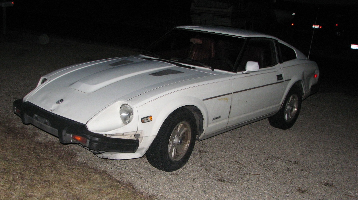

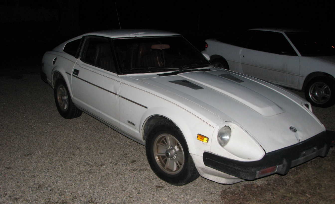

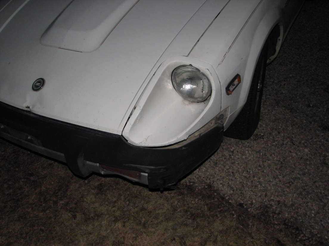

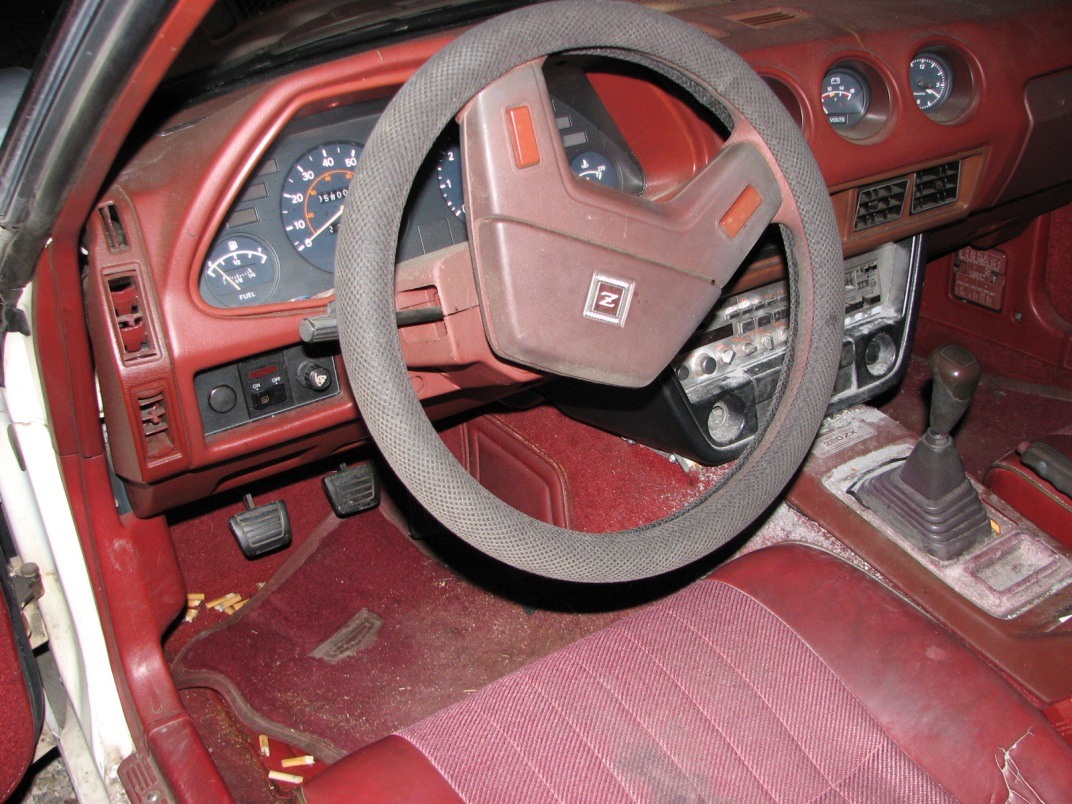

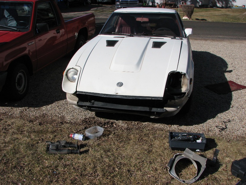

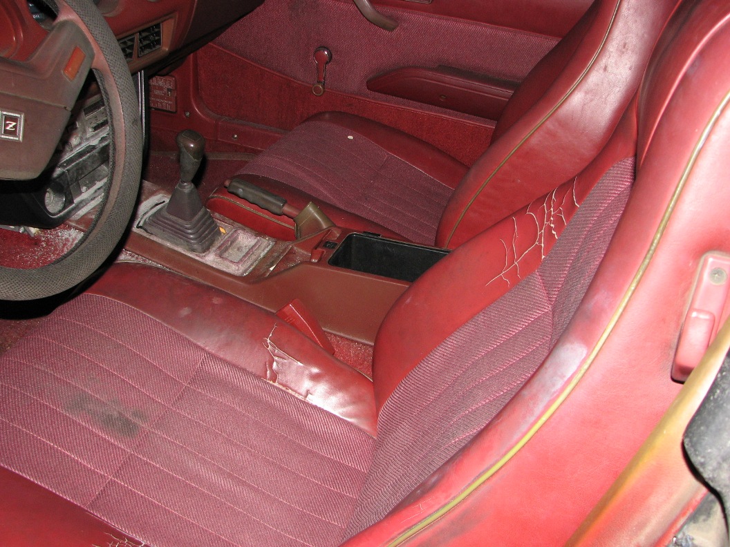

Just drove her home, posting a few pics. That gray stuff on the dash is cigarette ash, nasty. It has the typical rust in a few spots. So I have a lot of work ahead of me. Need to remove the front bumper to get the hood up. Looking forward to the weekends

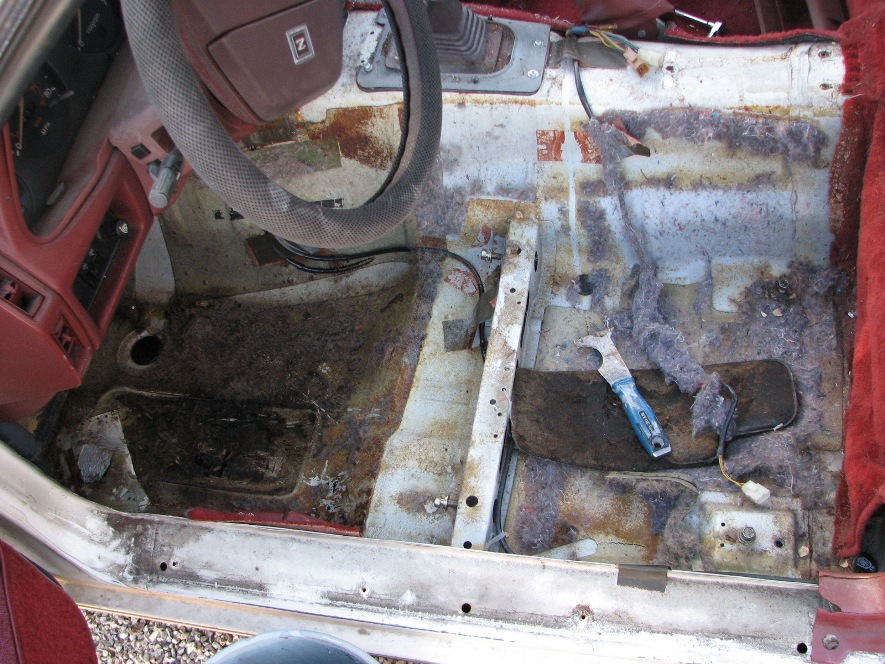

I removed the carpet on the drivers side, it was soaked in oil, perhaps brake fluid,as the brakes were loosing fluid mysteriously according to PO. No rust, just pieces of old carpet pad and lots of glue. Any pointers on cleaning it up, as far as getting the glue up? I was thinking lacquer thinner.
Removed the front bumper, it has some damage to it and the headlight bucket on that side also was also damaged.

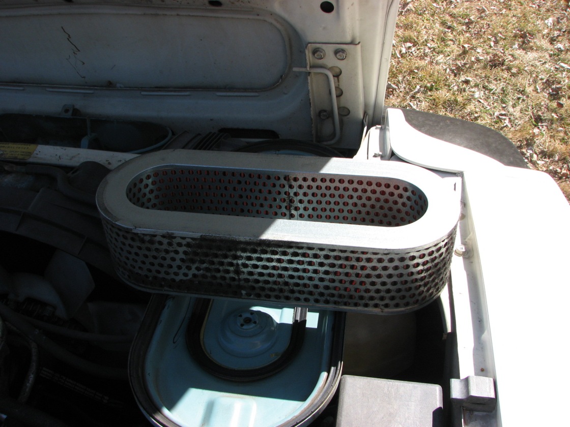

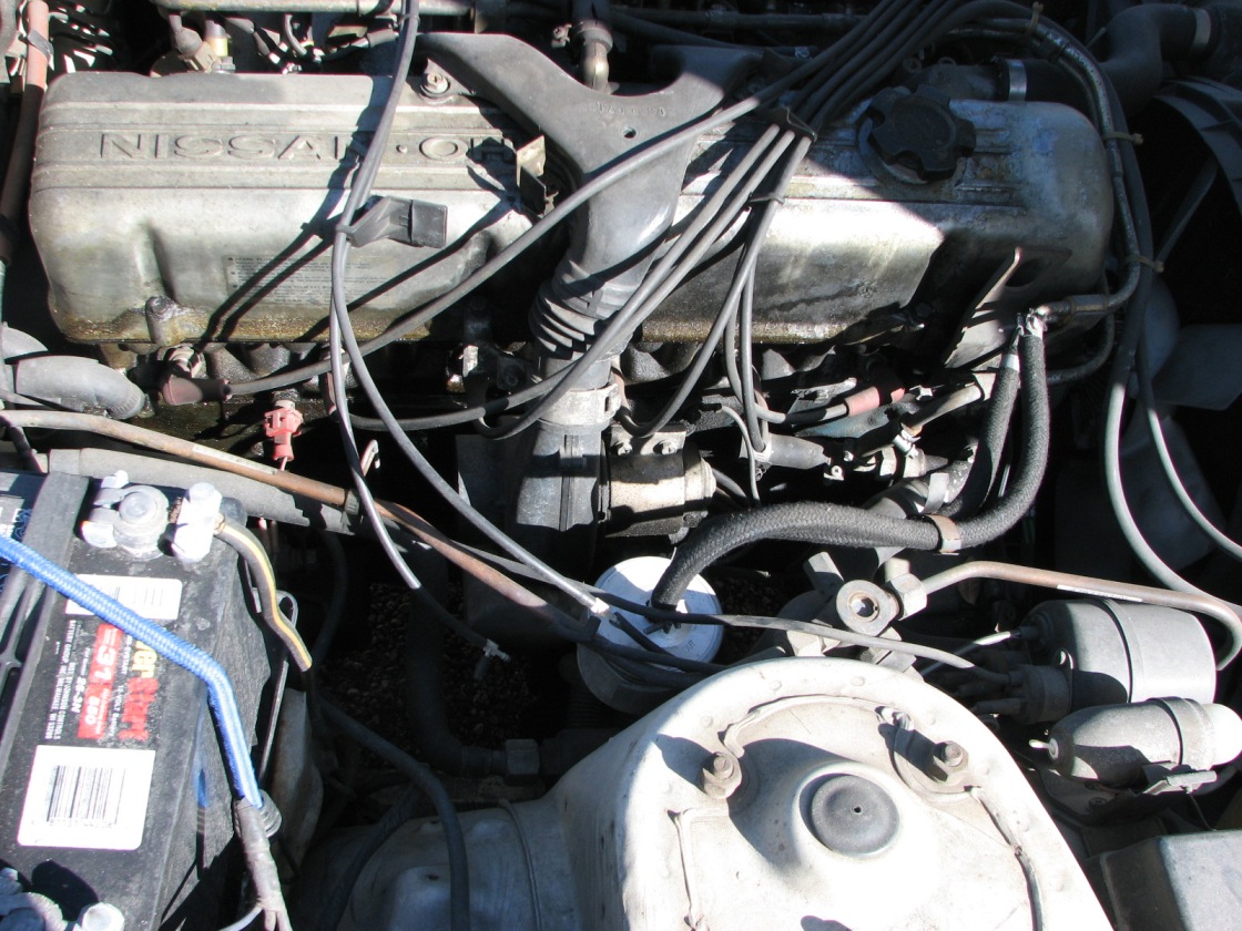

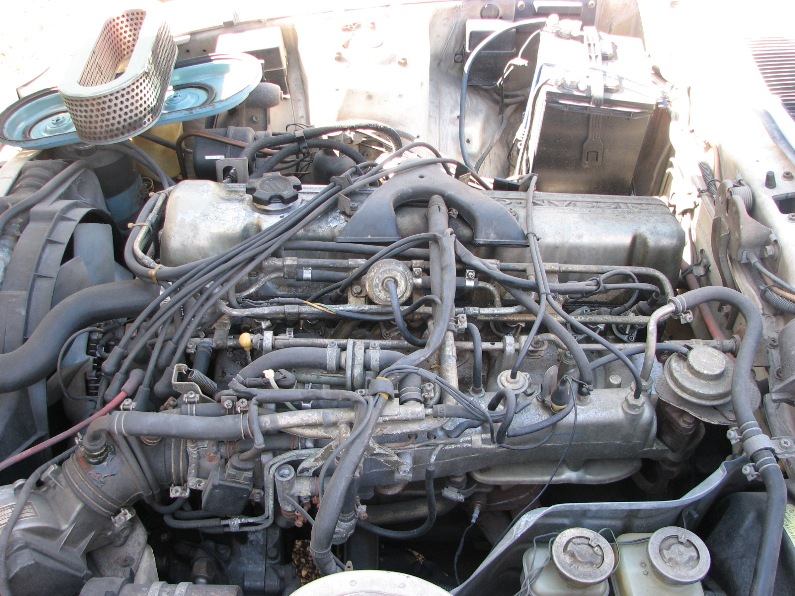

The engine looks like it has most the original parts, nothing deleted except the heater, which I have a new core for. The vacuum lines are very brittle. Oil leaking out of the valve cover. There is what appears to be a serviceable air cleaner, has anyone seen one of theses before, Im guessing they are common.

I know k&n has those style air filters in their store. Im seeing that most of the guys on here opt for a cone filter in front of the rad.

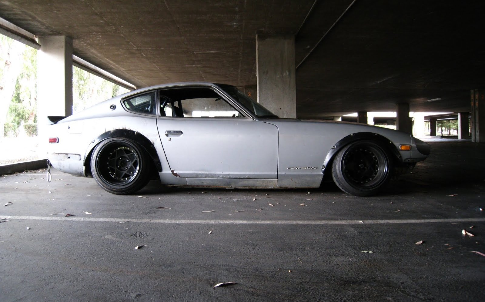

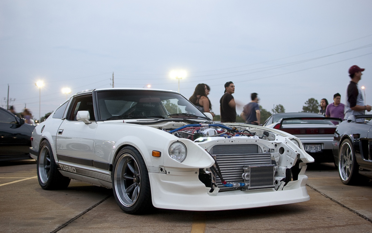

I really like the look of many of the Rat Rod S30's Ive seen with fender flairs, but I haven't seen any examples in the 280zx, any opinions ?
These are a few examples of the look I'd like to achieve.

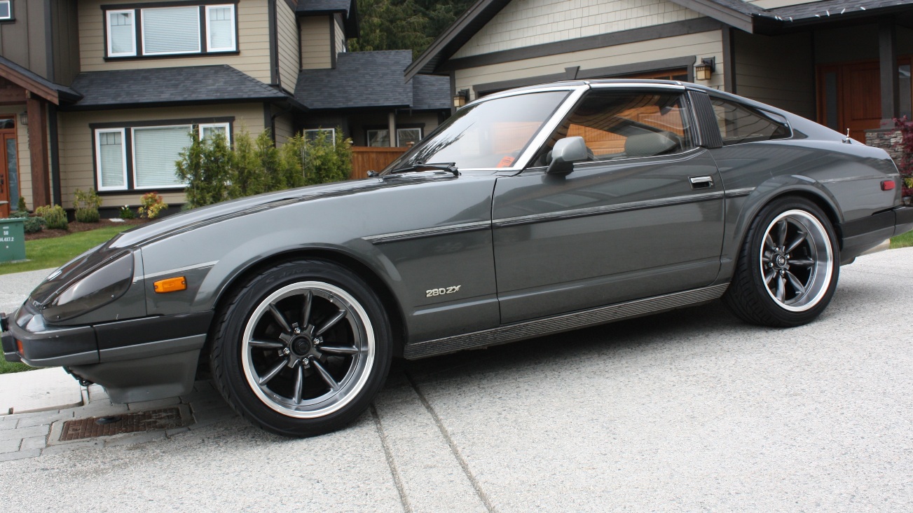

If you want to flare the S130 you're gonna have to go big - standard flares are the same size as stock flaring. Get the big ZG flares... You're gonna need huuuuge wheels though to fill 'em up. I'm running 17x9.5 with -19mm offset on stock rolled flares.
If you want to clean up the sound dampening try dry ice. You'll need oven mits to keep from freezing your hands but once you freeze it you can hit it with a rubber mallet and chip it off with a flat blade screw driver, etc. Works great!

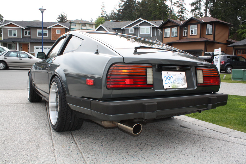

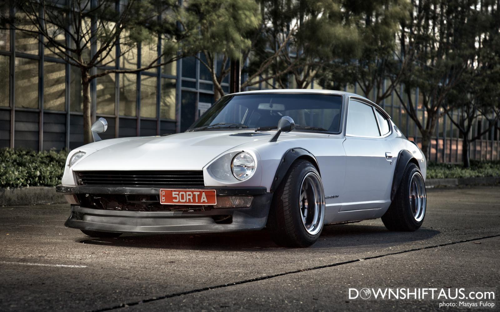

I like the fit on yours and this white 280, and all you did was roll your fenders ? Did you use the same tire size front and back, offset etc ? I can live with that, looks sweet how the tire fills it up so nicely. For the full effect, what springs and shocks / struts do you use ? If I did go with flares than Id be looking at a little more than rolling the fender, which can get messy. I'm not against the idea, but it is nice to be in the option phase. I'm going to search for some write-ups where cutting back some of the fender and welding it all up etc, what is the ultimate flair install that involves form, fit and function.
Appears both cars have the same wheels too, coincidence ?

I'm running HPK255's (for now - I'll likely do an S13 coil over conversion when funds allow ) with Rota RB-R 17x9.5 -19mm 235/255. Yasin is running the same but 255/275 and they look wicked!
No coincidence - once I saw the Rota's on Yasin's car I didn't care if I was copying IMHO they are the nicest fitting wheels for the S130

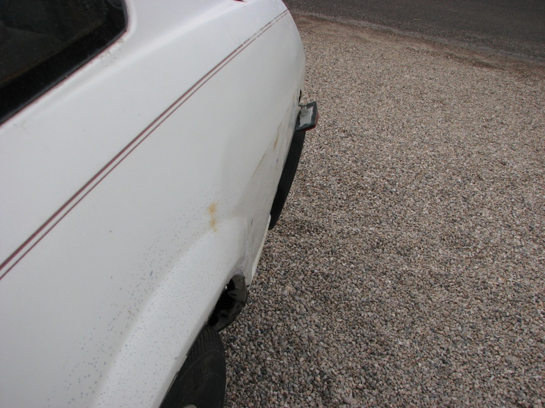

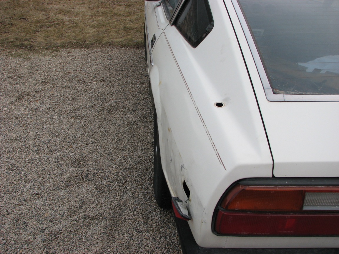

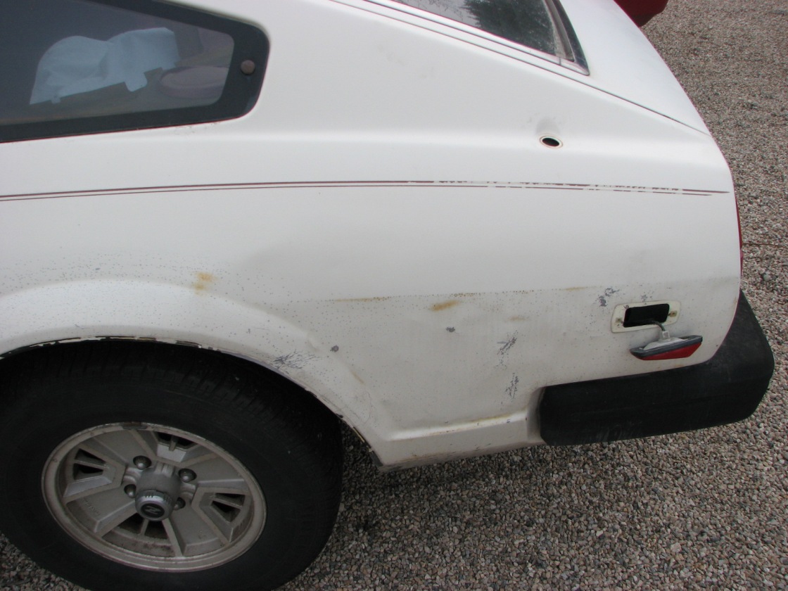

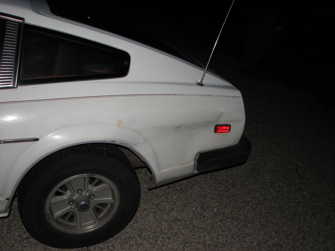

Decided to try and pound out that major dent in my drivers rear quarter panel, after taking apart the inside I was able to get to 90% of the dent. I didn't have the correct tools so I improvised with a sledge hammer, framing hammer, 2x4 and framing pry bar. I was pretty happy with the results, now I want to get a few pro tools like Super price on Mechanics Time Savers PB47K at ToolTopia.com, looks like I could fix anything with them... hehe. So heres the B4 and after so far.
