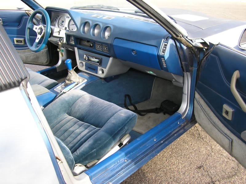

This what I did with my '82 280zx with an aftermarket Pioneer stereo and faceplate custom painted. Sadly this Z is destroyed by the sun and weather, and I will have to start all over again. I put a lot of time and money into it and it went to waste. Don't slack or neglect it after fixing it up or you will regret it. Good luck man..

Nice clean setup on the radio.. ? - What did you use on the faceplate that the radio is mounted on? Plastic, metal,wood?
I also like that steering wheel.. Where was that picked up?

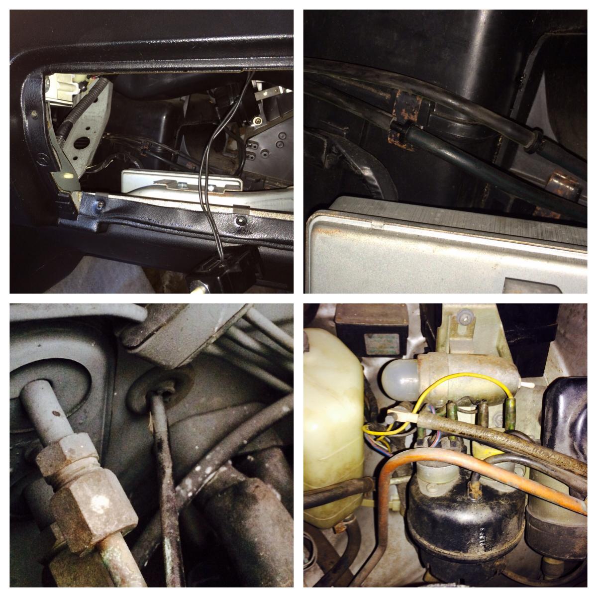

Working on electric windows and AC/heat vent issue.. Air would never blow out the center vents so began checking connections and vacuum pump by the engine compartment light..
Ground and power were all good at pump, vacuum good, hose thru fire wall good. Pulled glove box and found hose disconnected. Took a few pictures (posted) on these. I thought this may help others.. It actually was not to bad.. Vents working now...
Windows needed lubed and just normal maintenance. Windows now quick and smooth.

Are you asking about the blue faceplate? It is an aftermarket black faceplate for aftermarket stereos that I painted Cobalt Metallic Blue. And it is made of plastic. And thanks for the compliment. I wish it looked that good now. lol Good luck to you man.
As for the steering wheel. It is a Grant Signature Series black, that I painted silver in the middle. Turned out pretty nice, and I was quite happy about it. Anyway you can pick them up still new though they are pricey. I got mine used on Ebay, and got the steering wheel adapter kits for them. I love those wheels.
