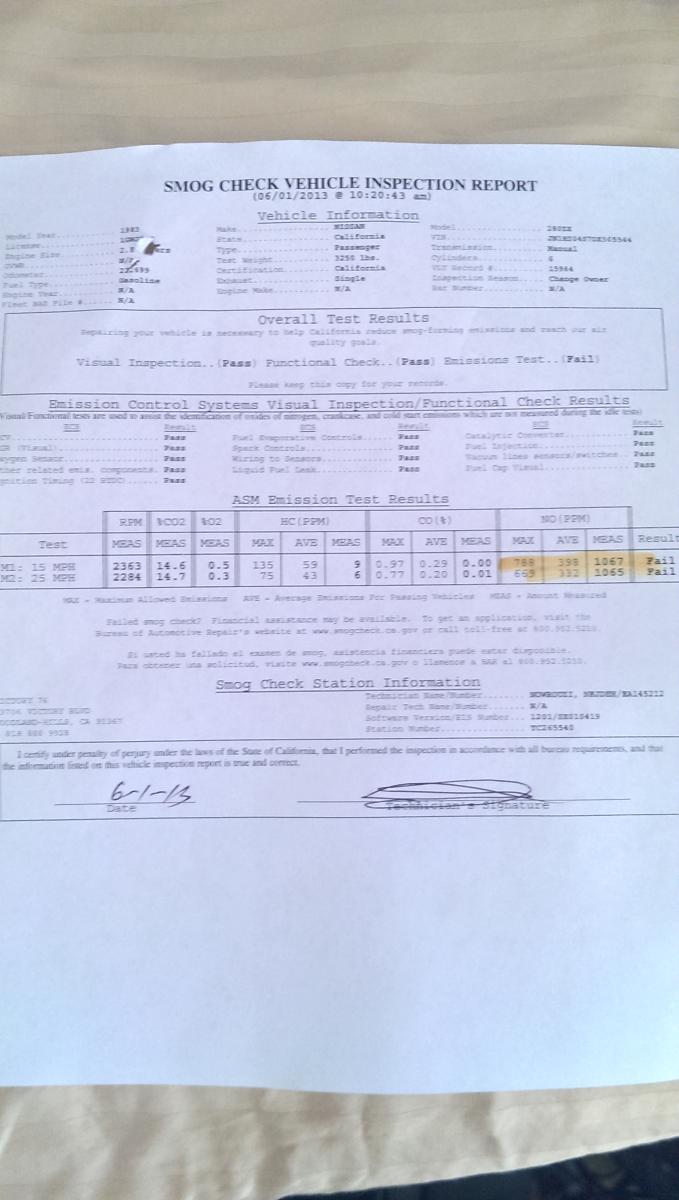

Thanks for the responses.
this is the old smog check.
That is the newest one.

Old Jun 2, 2013 | 08:16 PM
  1. Get rid of the old gas.
  2. Check timing.
  3. Check / read / replace spark plugs (NGK's only!).
  4. Check / replace spark plug wires, cap, rotor.
  5. Check / change oil.
All the stuff you SHOULD do before taking a newly acquired car to emissions.

Thanks for the advice, I filled it up with gas, drove for about 20 mins at highway speed and then it passed.
