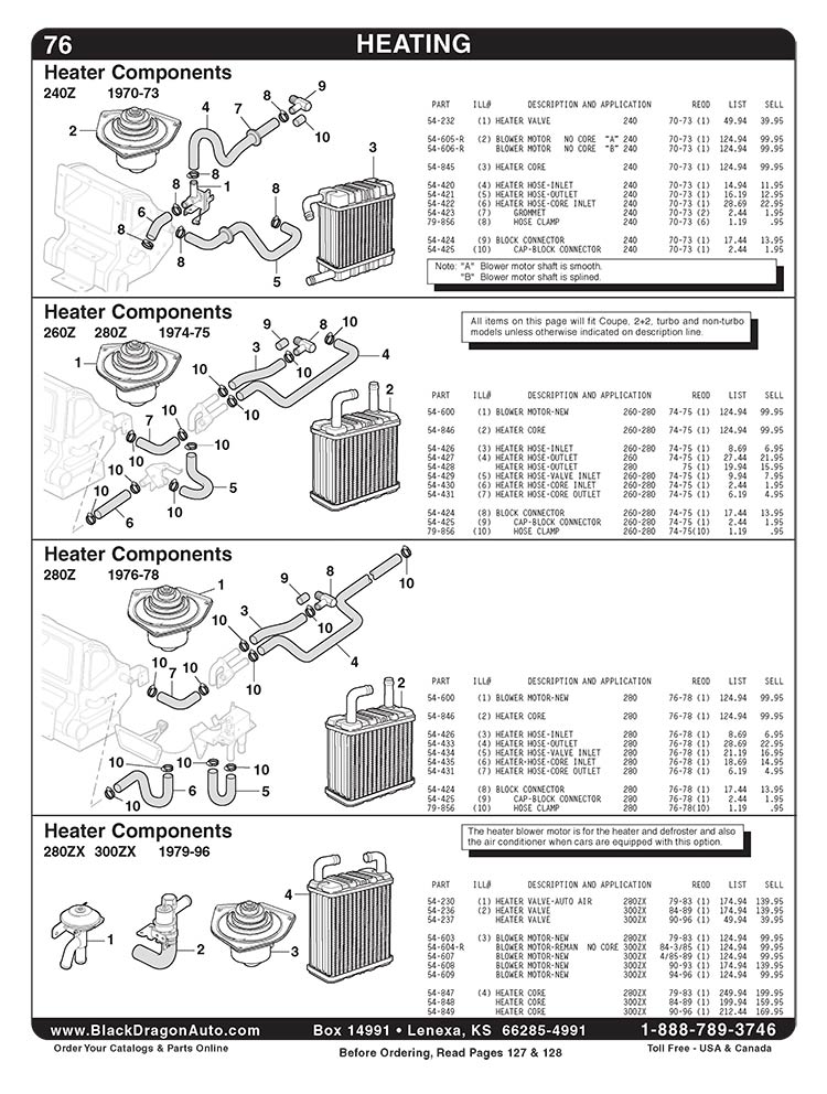

All I see new is for the Auto air set up. Will it work for the manual set up as well. That is what I have as well. Here is the BlackDragon page with the auto valve.
