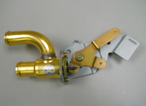

The new one that I am buying is the 27116-P6500 and I am getting it from a local Nissan Dealer and looks like this
Thanks guys! you have saved me. I cant wait to fix my car and get it running. I am very excited about this buy.

thats the capillary tube that i ended up cutting off., i cut it back as far as i could reach it.. im not sure what that tube did.. the replacement should work fine.. just have to mount it on different mounting points.. you will have to adjust the push /pull cable once you install it..
