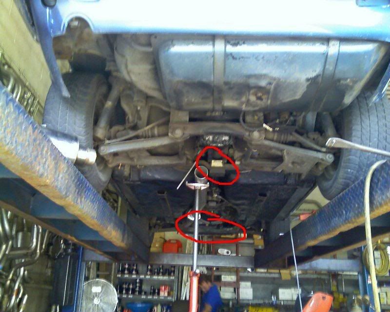

Where did you try to lift it? If you have access to a floor jack, you should only jack it up by the front cross-member or the rear differential.
If you're using the spare tire scissor jack, you should only jack it up by the jacking points indicated in the owner's manual.
Anywhere else will buckle the sheet metal. Countless frame rails, floor boards and side's have been damaged this way...
Old Nov 15, 2007 | 11:21 PM
theres jacking points on the front and rear cross members. look at them, and you'll see what looks to be a square hunk of metal, yeah, thats teh jacking point. its all nice and flat and solid for you. if i had a picture id post it... i might actually, ill have to look in my photo bucket account
EDIT: cheer you go. circled in red is the jacking points. the front is actually the engine cradle/crossmember, just jack in the center of that. the rear point is actually a solid block of steel under the front of the diff for jacking. only places a jack should be placed on these cars. hope this helps
