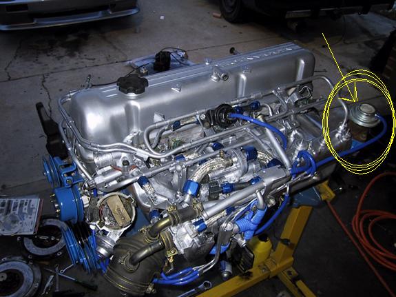

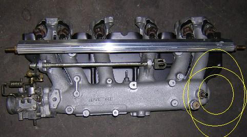

all ZX's had a EGR, so if your doesnt, some one changed your exhaust and intake manifold already. it would be a large, circular looking selonoid (similare to a mushroom shape) on the very top back portion of you intake manifold, IMPOSSIBLE to miss. IM-F'ing-POSSIBLE! lol. so if you for sure dont see it, then its not there. there's no tricks in this game.
Old Dec 18, 2007 | 07:26 PM
Attached pics... N42 non-egr intake. P79 egr intake ( egr is circled in yellow )... courtesy of ICICE's cardomain page.
AFM = Air Flow Meter... the flap door box between the air filter & throttle body.
Attached Thumbnails Major Problem...-manifold3sm.jpg   Major Problem...-336708_14_full.jpg

Lol, we checked the AFM without any knowledge it was called an AFM.
Yeah, we have that N42, no EGR could my EGR/ECU theory be causing us a bad idle?
