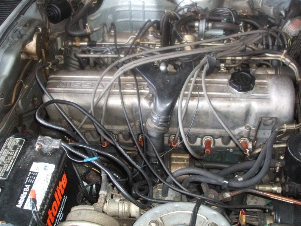

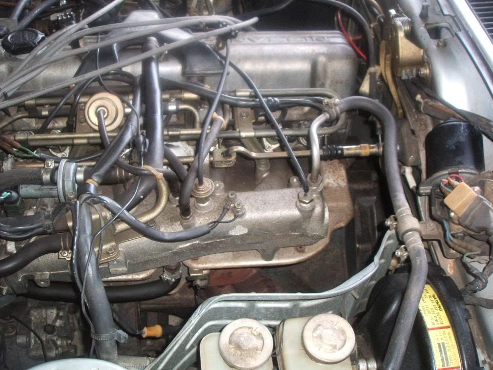

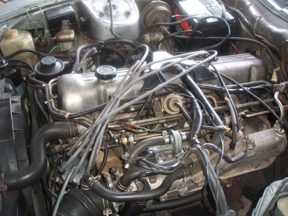

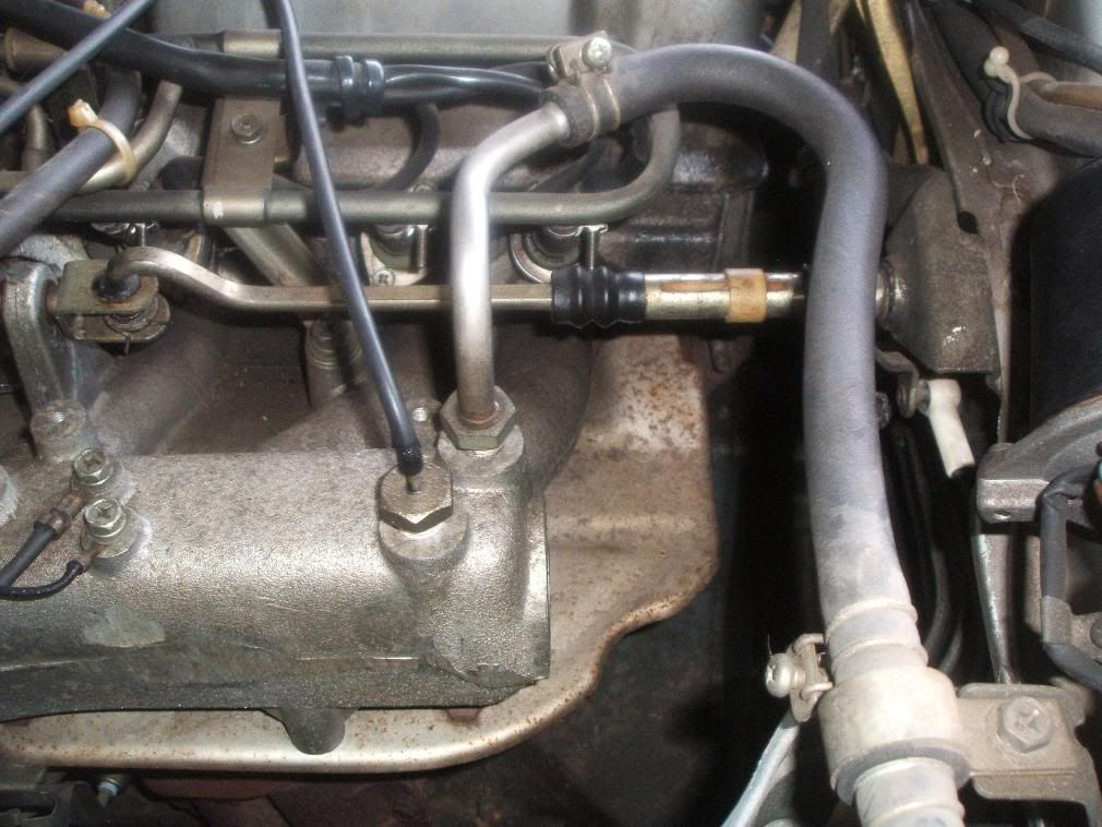

Yeah somebody definately switched out the intake. That would explain why you have no EGR at all. Even the oil cap looks different from 280zx's I have seen before. So anyway I also noticed you don't have a fuel/air mixture screw. I use that on my 280zx's to adjust the idle, after setting the AFM mixture. But maybe check your timing, and see where it is at. It should be at 8 degrees before top dead center. That is all I can think of for now. I am a loss at the moment. If I figure something else out. I will be sure and post it here. Good luck and welcome to Zdriver.
We don't have a timing light yet, so we can't set it at 8 degrees before exact, we set it based on ping startup. It's primitive, but it works. We do have an Air fuel mixture screw! We were just tweaking it. We'll get the timing precise ASAP, for now though what could be causing that RPM surge?

ok, what was 2-3 teeth off? distributors can only go on one way... oil pump shaft can go in wrong but there would be NO reason to drop that for smog reason. and how would you know if the dizzy was off timing and is fixed now without a timing light? are you just playing with the timing without a clue of what your doing?
alos, WTF intake manifold is that? its def not a N42 because it has the webbing.
Old Dec 19, 2007 | 02:32 PM
  #42
Silly boy... low timing = better emissions.
I think there is a rare P79/P82? intake that has webbing but no EGR.

I believe Nismo is right on the intake. Like I said in another thread someone on HybridZ was mentioning the webbed intake that came off a ZX that had no EGR. P82 or something like what Nismo said.
