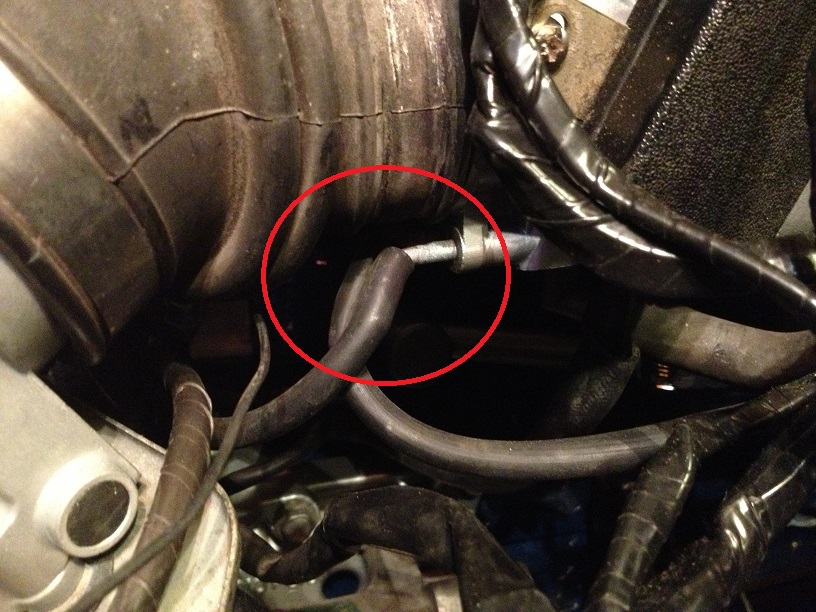

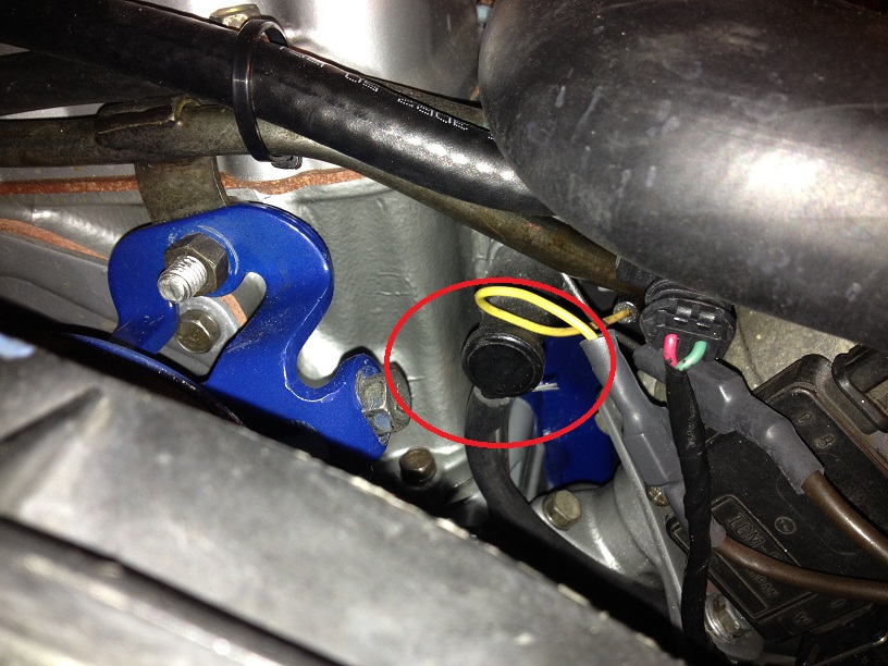

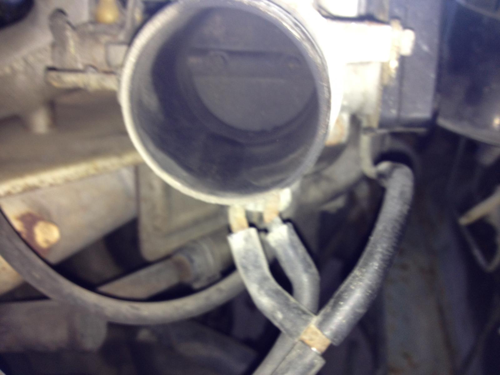

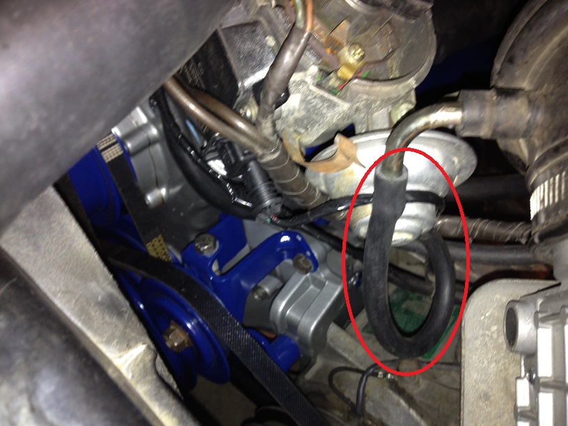

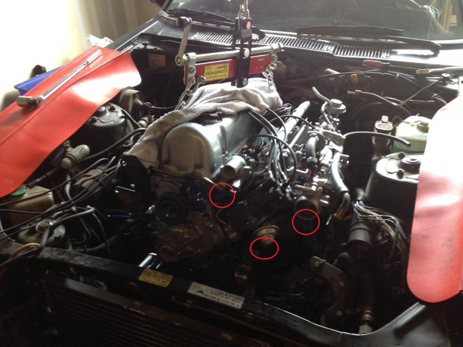

The way I did it was first look for cracks in the lines. As you are doing that give each line a light tug where it connects to see if the hose comes off. It should have some resistance to it. Also, there are a few hoses hooked up in the front of the motor under the throttle body and thermostat. I will try to include a picture tonight, I know how hard it can be to find a good pic of these.

pics of vacuum lines
These should help you find the ones on the front of the motor.
