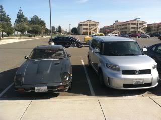

Recently i bought a 1982 280zx 2+2 turbo for $700 and got it running with a new fuel pressure reg and a new battery. The only things that dont work now are the heater and a/c. When i turn the heater or a/c on nothing happens, no air flow at all and when i move the selector switch to diff positions (i.e vent, heat etc) i hear a "psssst" hissing noise for a brief moment below the dash.
I plan on redoing the interior. Iv already stripped the carpet, headliner and panels and im going to repaint the trim and vinyl. My major concern with the interior though is the hump where the back seat was because i took it out. What should i do with the hump? Im considering just putting a carpet kit over it and putting subs in the holes, or how could i make it flat all the way back to the front seats? Thanks guys im new here.
heres the only pic i have taken a few days ago
