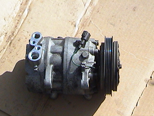

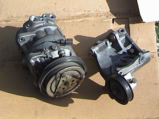

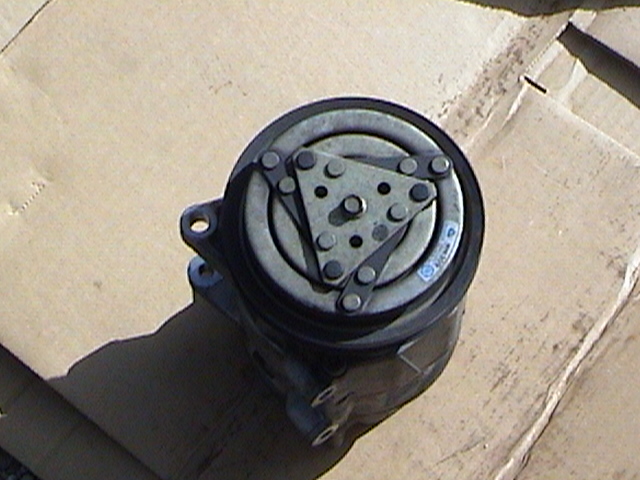

and another warning before buying an a/c compressor. the 96s have a different one from the 90-94s. i forget what is different right now, but i have one of each out in the garage. so get it checked out at a shop before you buy one anywhere
You serious i just pulled mine for nothing.jk. Here's the pics. So whats different. Well if it's not the right one it's going through a window. My j30 is a 94'.
Attached Thumbnails 1st ZX - 96 N/A 2+2 - pic & a few questions...-dsc00256.jpg   1st ZX - 96 N/A 2+2 - pic & a few questions...-dsc00257.jpg   1st ZX - 96 N/A 2+2 - pic & a few questions...-dsc00258.jpg

sorry theyre kinda dark. but the one on the right is the 95+
and the pipe is bent, its not supposed to be like that

Damn so the difference is the in/out locations. The 90-94 looks a little bigger also. Well might as well start the mods with the a/c. You think he can engineer it, are the belt areas at the same postion, same measurements. Etc? It looks like they'll interchange, the bolt up pts. are in the same position as well as the belt. It would be easy the change those up. What do you think?
