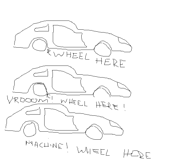

Old Jun 21, 2011 | 07:00 PM
  #546
From: Victoria, BC
The problem is at very high HP numbers the flex in the sub frame moves wheel forward in the wheel arch. The S130 rear wheels are positioned forward in the arch. The stock bushings where the subframe mounts to the car are offset and that moved the wheel forward in the wheel arch. When you machine new bushings moves the wheels back 0.3" towards the center of the wheel well and the solid bushing reduces deflection towards the front of the wheel well under acceleration...

Joined: Feb 2009
Posts: 3,176
From: Vernal, UT
^^^ What?
Old Jun 21, 2011 | 07:49 PM
  #548
Skully's Avatar
Joined: Feb 2002
Posts: 2,906
From: Saskatoon, SK
lol

Old Jun 21, 2011 | 09:42 PM
  #549
BlueKitsune's Avatar
Intrawebz Wizard
Joined: Feb 2009
Posts: 3,176
From: Vernal, UT
Does it actually move forward enough to be a problem??? Geez. Learn something new everyday.
well, for instance look at my car:
and that's 3.5" shorter than stock with 1" shorter overall diameter tires.
but I'm not doing the solid bushings just for the .300" it moves the fender back in the fender lol just making the whole thing act as an actual part of the car instead of having it flop around when I downshift and clutch kick and transition and all that stuff.
