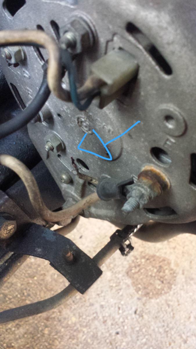

The battery has the tie down on it yes. Loose wiring sounds like the problem because my relays are fine. The alternator also has a loose wire coming out of the end of it that my 83 doesnt. I will upload a picture? Could it in anyway be my ECU going bad?

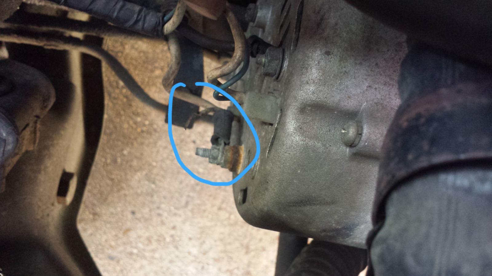

Here's the alternator wire that isn't connected to anything.
I was taking pictures and touched it like a Dumbass without removing the battery cables, it barely touched the back of the alternator and sparks went flying. Luckily i didn't make things worse.She still starts

Are you pointing to the white wire? That's the live wire to the battery... so is it hooked up properly now?
The alternator looks exactly like it does in the picture still. There are 2 white wires coming from that bolt. One connected to the battery cable and one really short wire that's been cut and I can't find the other end of it. Try looking at the picture one more time a bit closer. it's hard to catch.
particularly the one with the arrow is clearer to see
