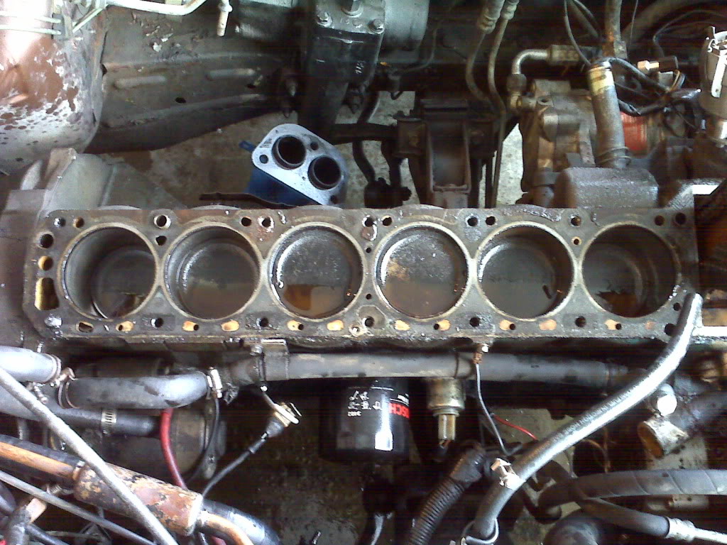

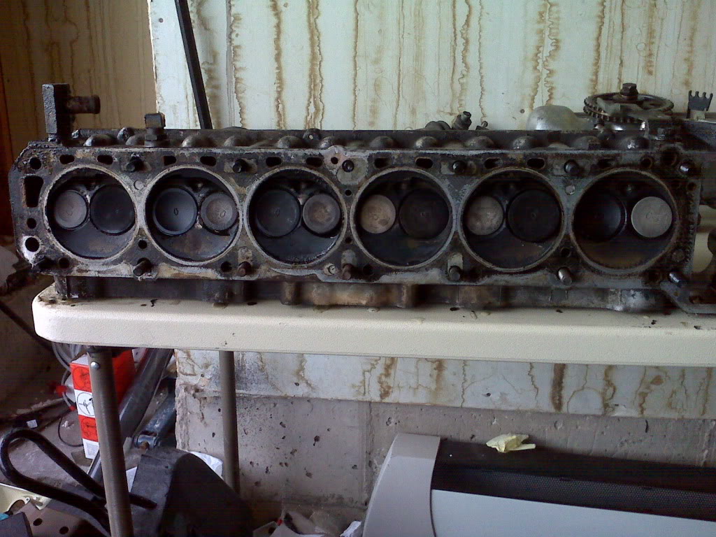

Engine head is ok
Block is ok (thats PB Blaster in there. I ran out of wd-40)

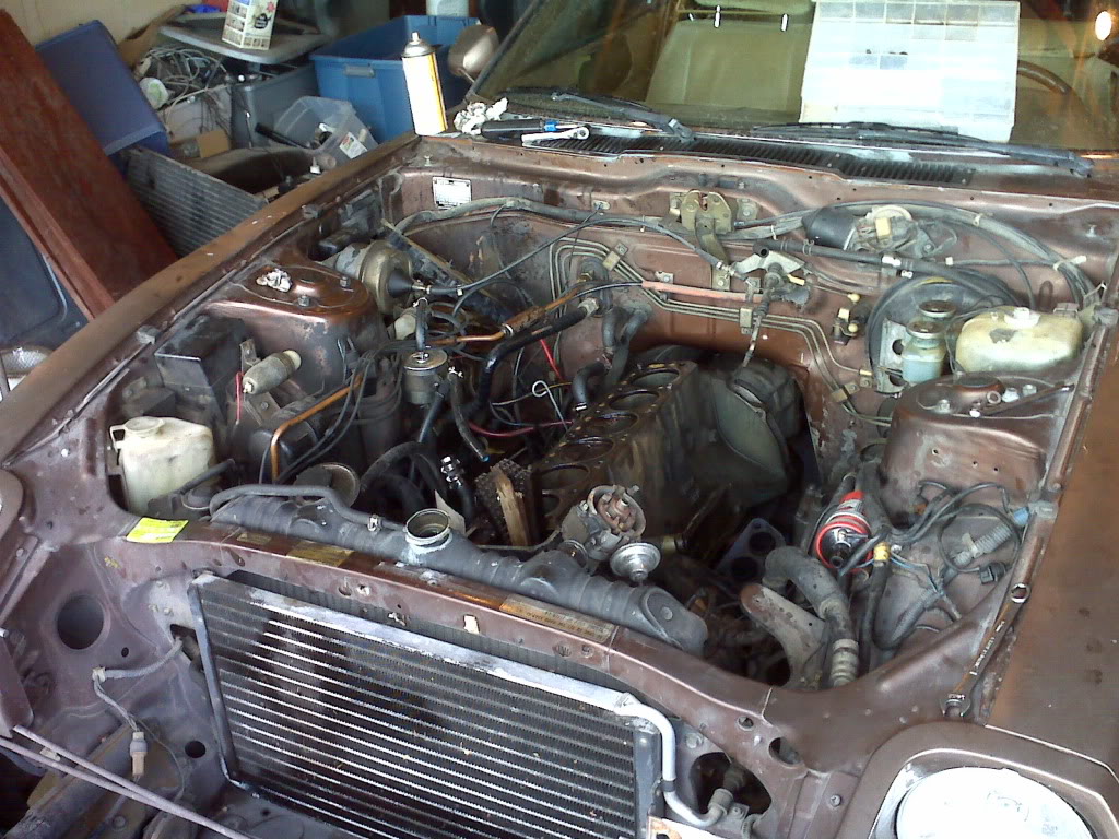

The Z

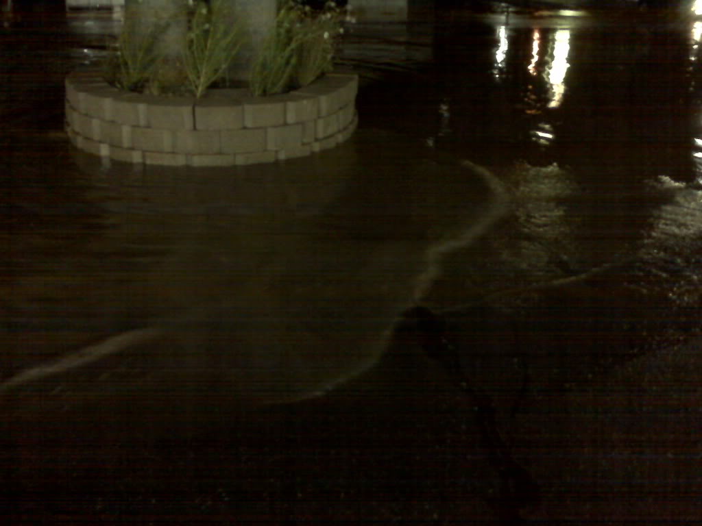

The evil that killed my Z (that garden thingy is only 3 blocks high with maybe 6 inches of cement to stand on)

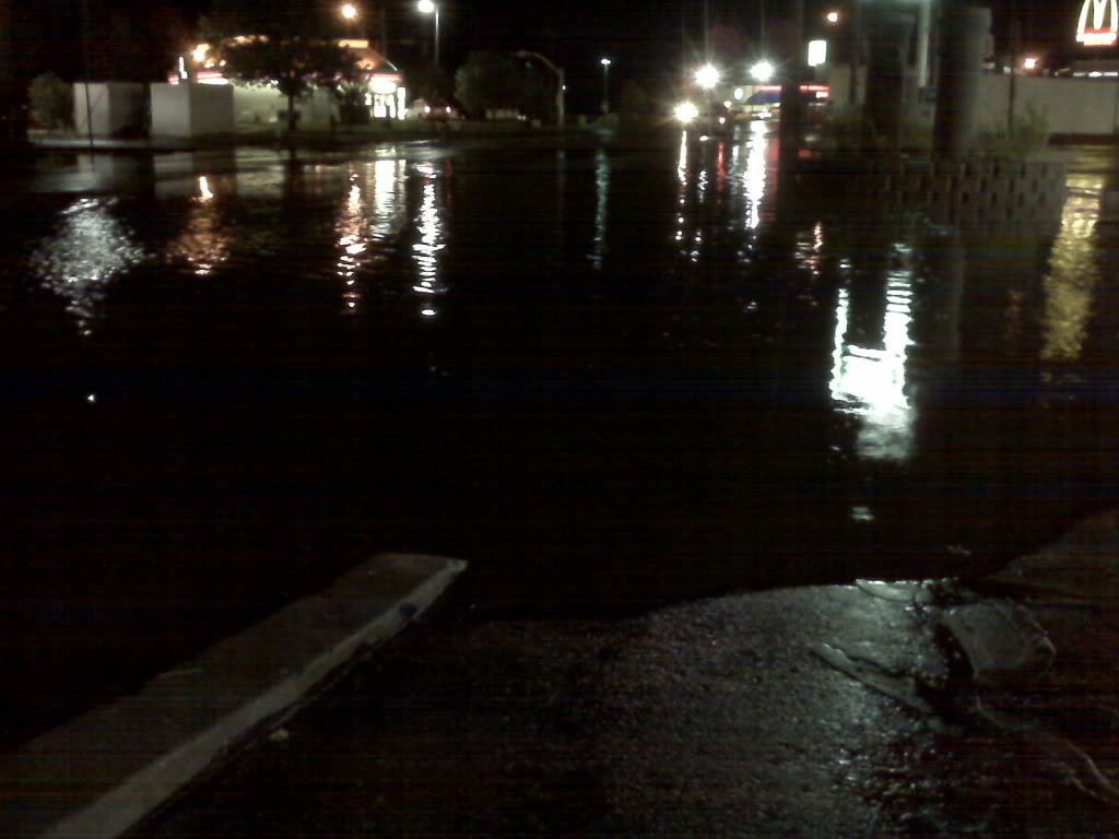

Another shot. that water was only around a foot deep when I checked it later.
Soo ya. Open airbox + semideep water + speed = waterlocked Z engine
