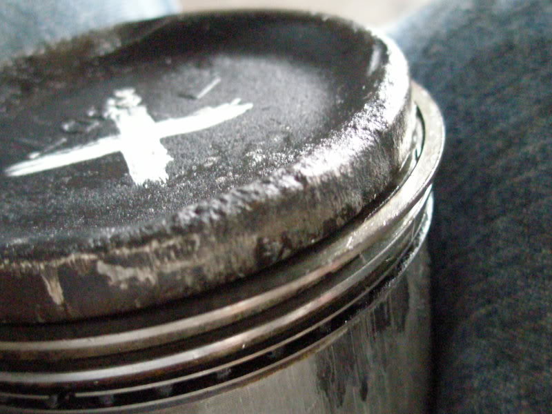

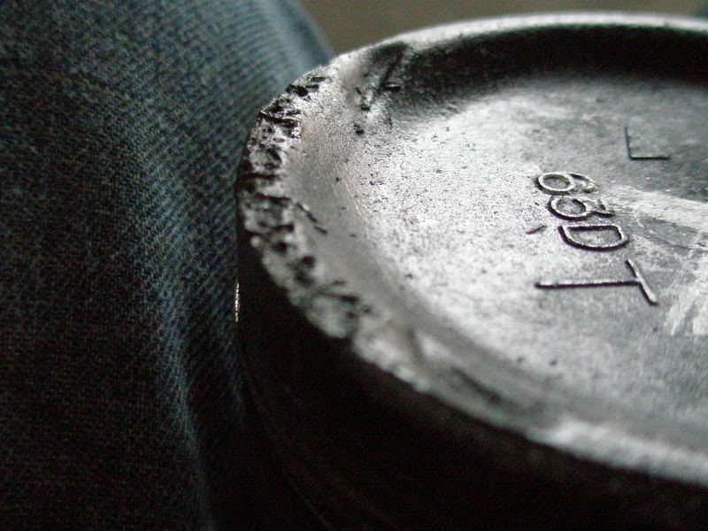

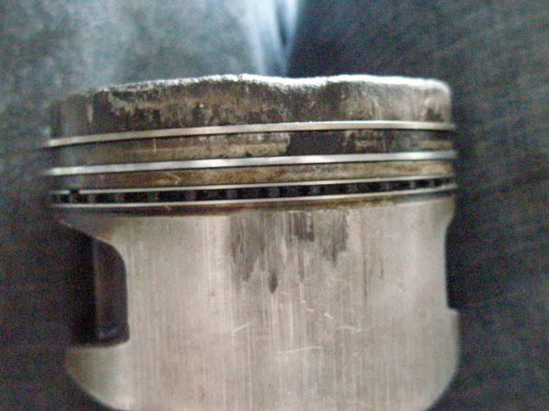

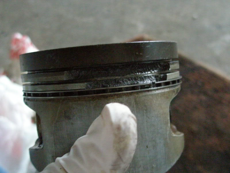

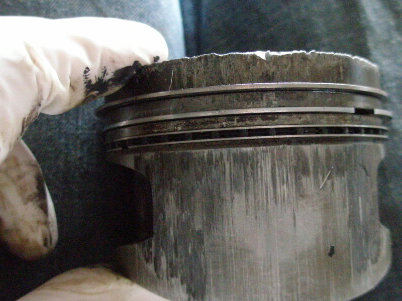

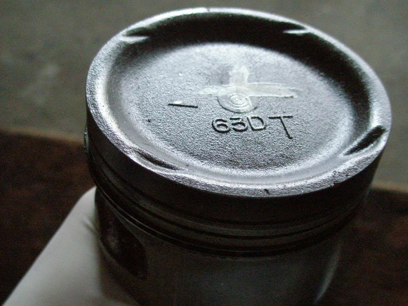

i blew a HG and almost full hydro locked my DSM motor on its own collant, when i tore it down my rods were ok but two pistons were TERRIBLY worn and had some stress cracks around the piston ring retainers. i have a thread here on it, so i just replaced them for free with the same 2 rods and pistons from my buddies galant VR4 got new bearings for them and honed the cylinders got me an evo3 MLS HG put it back together and it has perfect compression without being ran.... then i jumped timing and had to re-rebuild the head lol, ground up rebuild. only old thing in is is the valve springs... but i re-used the MLS head gasket since it only ran for a 1.4 mile total... seems to be doing just fine! though it loses power in the high end and my turbo is shot! F this car.

what hydro lock did to my pistons

From what I can tell, the pistons seem to be perfectly fine. that engine stopped dead when it hydro locked. Im thinking it sucked in so much into 2 cylinders at once that it locked the engine w/o to much pressure, I see no cracks anywhere.
