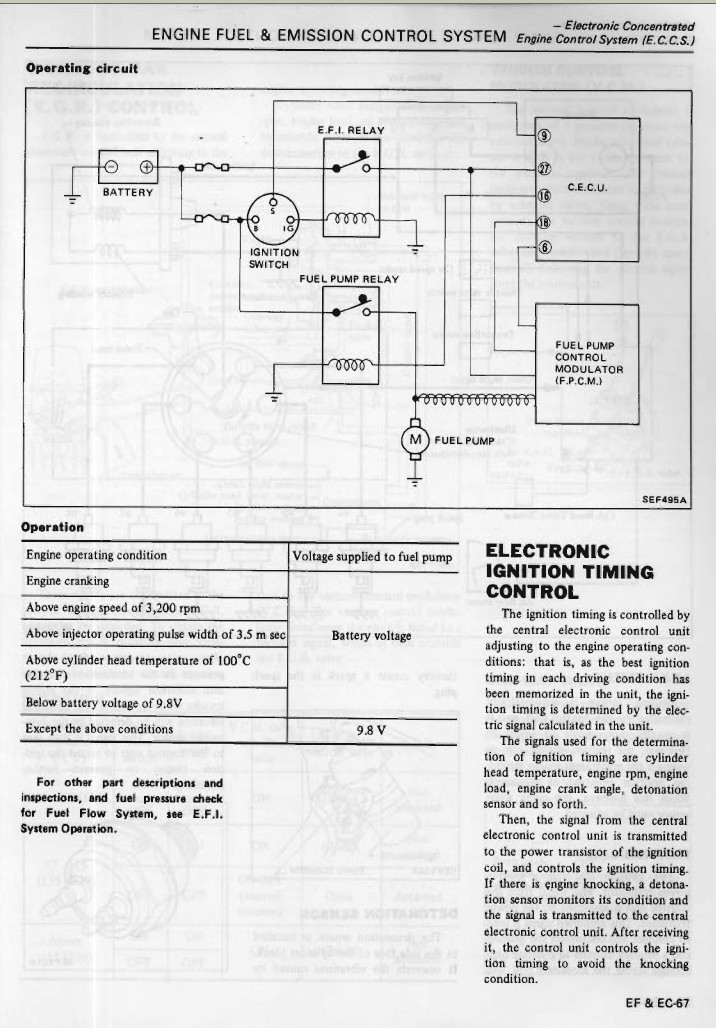

My turbo Z still primes properly every time. The fuel pump relay turns on and off so I think it is working fine. Its whatever sends a signal to the relay. The ignition, ECU, and pump controller all are interconnected and control the relay and the voltage to the pump. I just read a bit in the Factory Service Manual about that fuel pump controller.
When I did my turbo engine swap, the fuel pump relay is part of the ignition and dash wiring harness so it opperated on its own without a fuel pump controller as part of the system. I installed the turbo ECU without that controller and it worked fine. Now I'm working with an original turbo Z.
I bet my controller is switching the fuel pump from 14.4v down to an error of 6v or less instead of 9.8v
It sounds like when I bump the throttle, the controller kicks back into "battery voltage" mode.
The controller is fed by the CHTS and the crank angle sensor. Besides the controller being bad I guess I should check the CAS plug.

bypass that module, take #27 and go to either #6 or #18. or both in combonation. while its running normal you could check each of those for power and tap #27 into that particular one. you dont even have to fully remove the module until after you test that bypass works. i did it with my intermitant wiper control module when it burnt out. dont forget to wear the glove when working and a groud strap.

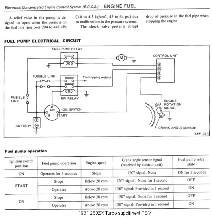

the FSM shows that the controller sends a ground signal to the relay. I had thought it was sending power. Its nice that the 300ZX turbo sends the same to the relay.
Anway, after checking every other possible connection I went back to the FP controller and unplugged it. I found that the large white wire was the signal to the relay. I grounded it out and the fuel pump stays on while the car is on.
I'll leave it like this for a while and drive it. No need to replace the controller. I'll just get my Z31 ecu put in this summer.
