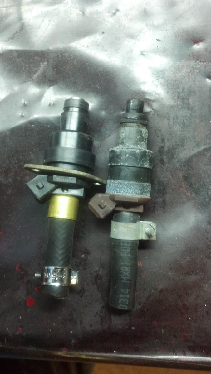

3 of my fuel injectors were leaking on my 280ZXT so I decided just to replace all 6 injectors as well as the seals. I ordered Standard Motor Products Part # FJ23T as well as the seal kit. I pulled off the fuel rail, pulled the injectors, cleaned out the bore they sit in with carb cleaner and replaced. There are some slight differences in design at the injector tip as you can see in the attached picture (new injector is on the left). After I put everything back together, energized the fuel pump and crank the car over, it fired a few times before it died. Crank a couple more times and the same thing occurred. After about 3 attempts to starts the car, it now only cranks over without firing. The car was running fine prior to the injectors being replaced.

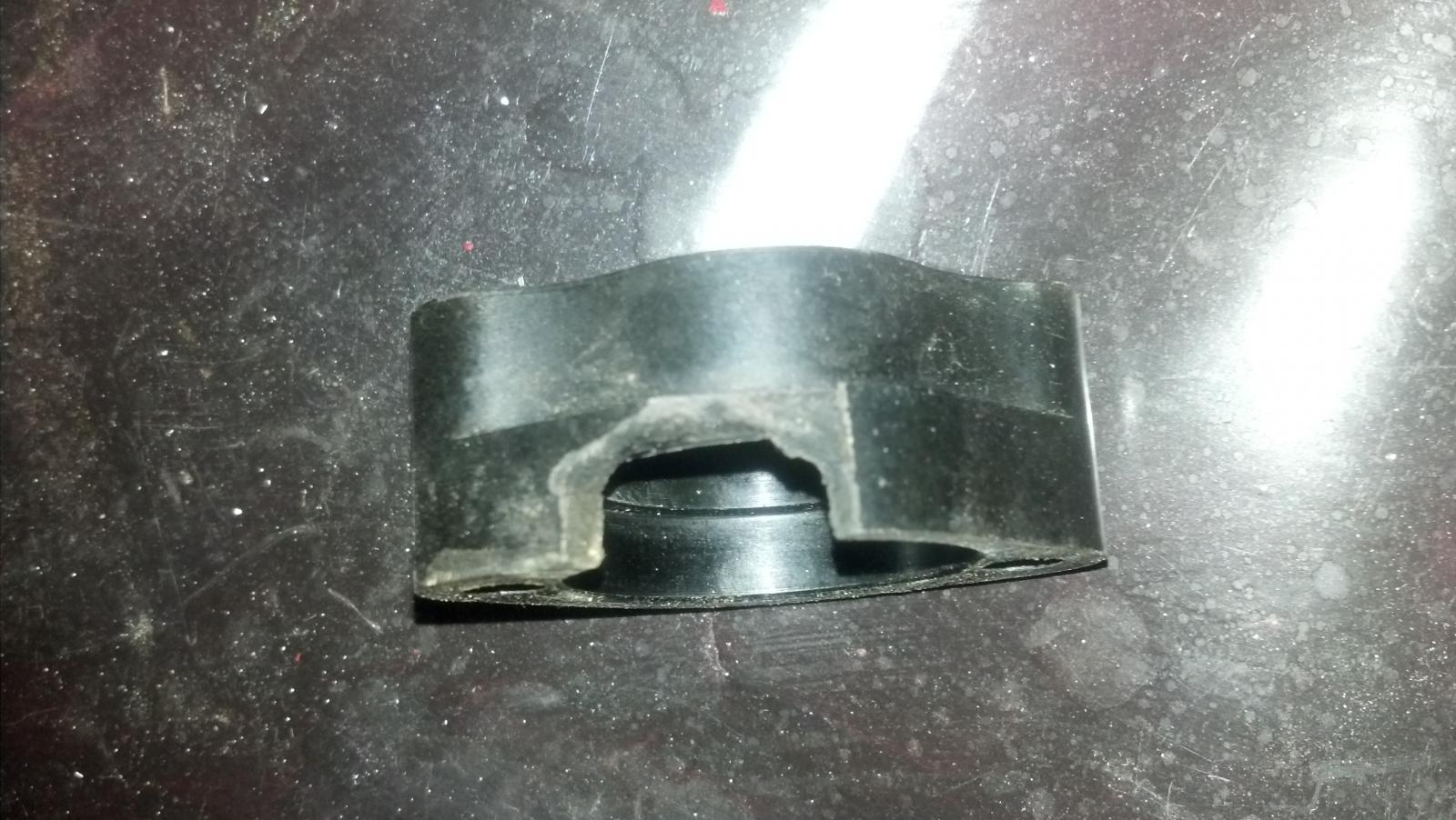

I also have two of my injector lower holders that are cracked (See picture). Does anyone have a good place to purchase these? Are they the same at the NA models? I also have 4 connectors that have become brittle and cracked. Does anyone have a good source for the connectors?

Interesting... I've never seen injector tips like that for the 280zx...
Did the seals sit tight in the intake upon install? I'd say there's either a nasty vacuum leak, wrong injectors, you didn't reconnect the AFM, TPS, CHTS, or maybe the spark plug wires got put back on in the wrong order...
You should be able to buy the injector holders at your local parts store. If not, then hit up ebay, MSA, BDA, or your local Nissan Dealer.

Ordered a set of injectors for a buddies 280z and got the same ones, they are supposedly the completely redesigned ethanol resistant injectors. They fit a little loose in the injector isolators, but fit nice and snug in a new set.
