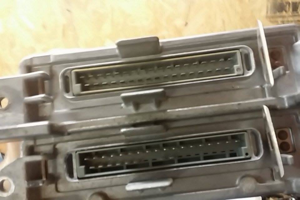

also I have two ecus both part number A11 600 000, but one is missing pins (possibly a '78) and the other isnt.
can anyone identify the years of these ecu's

What is the label # on the other ECU,from the picture you have(missing Pins) A11-601 000
A11-000 050
1975 M/T Calif
A11-600 000 is for:
1975 A/T Calif,
1976 M/T & A/T Fed & Calif,
1977 M/T Fed & Calif,
1978 M/T Fed & Calif,
A11-601 000 is for:
1977 A/T Fed & Calif,
1978 A/T Fed & Calif,

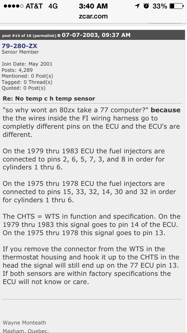

Honestly, my friend is my master tech and he is use to working on P79 heads. He totally whiffed on this engine rebuild. so i had to do research myself. My engine started idling, but it shuts off when i gas it and i can hear it misfiring after the engine warms up for about 5-10 mins. I just kept reading on found the picture below.

Old May 26, 2015 | 09:59 PM
So do you have a CHTS / Coolant temp sensor hooked up?
I'm assuming not since the N42 doesn't have a CHTS port, and you are using the P79 thermostat housing.
