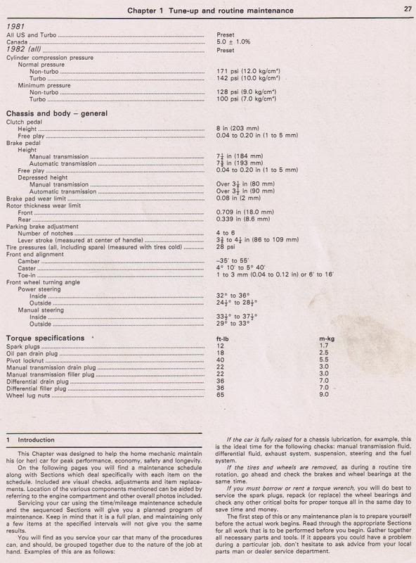

You could always MEASURE the rotors yourself.
Specs:
Old Aug 9, 2011 | 09:19 PM

All 280zx's came w/ 4 wheel disc... the S30 (70-78 240z-280z) had rear drums.
Originally Posted by macro4you
As to measuring the rotors myself - I trust myself to work on what makes the car go but I have a pathological fear of working on what makes it stop.
You aren't "working" on the brakes by taking a simple measurement. You asked if the shop is right... I'm telling you that if you have two hands and at least a metric tape measure (measuring caliper is better), then you can know if the shop is trying to take you.
Or you could just ask the shop what the measurements are, and compare to that spec sheet I just posted (front minimum is 18mm, rear is 8.6mm).

I ended up getting a second and third opinion about my brakes. Here are the conclusions. 280ZX rotors don't fail after 56,000 miles under normal conditions. All my rotors had a lot of meat left and could all be turned. My rear brakes actually didn't need any work.
My first brake guy I went to must have been mistaken about me needing all new rotors. I called him to let him know that his measurements of the rotors weren't consistent with the others. I wasn't impressed with his professionalism when he heard the findings. I don't think I'll be going to his shop again.
