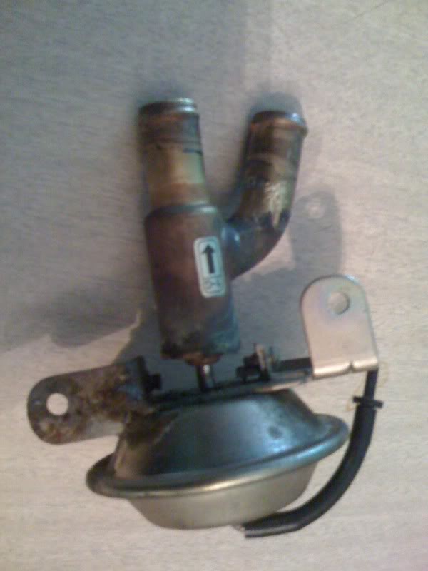

this is how my valve looks is it suppose to separate like split like that or is it suppose to be one locked together piece?

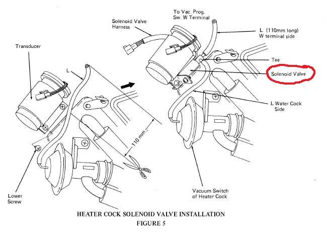

Solenoid missing
my 81 s130 does not have this solenoid on it if i hook it directly to the W port on the Vac program switch should it still operate?

Merged w/ your previous heater thread.
Yes, it should be fine. Those lines just direct vacuum, which is controlled by the slider vent selector.
