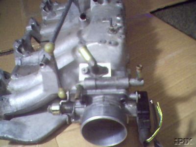

to run the big bore tb, and the stock afm, just use the turbo air filter rubber. the one that goes thru the front rad support to the airbox. cut it to fit, works like a charm. if your feeling crafty, you can even add in the hose ports for the idle air bypass. i didnt do that cause i removed mine. but was thinking of adding it back in!! heres the proof!!!

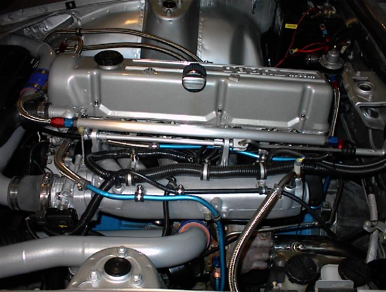

does anyone have a close up picture of the 240 throttle body and spacer set up so i can see how people routed the hoses and all. i would appriciate that sooo much!! thanks guys. also what have people been doing with the pigtail that comes off of the stock 240 tps? the 83' 280ZX turbo tps connector connects directly to the 240sx tps correct? but there is that extra pigtail on the stock 240sx tps....

There's not much to be routed... Just connect the j-pipe or IC pipe to the throttle body, and connect the air regulator tube. Usually people bypass the coolant passage through the throttle body. Here's some more pics from my archive, but it's really quite simple.

the air regulator tube is the little larger hose on the top of the throttle body correct? those are much better. thanks!
Old Jan 13, 2008 | 08:26 PM
Yep... goes from the tb (stock) or spacer (60mm tb) to the air regulator.
