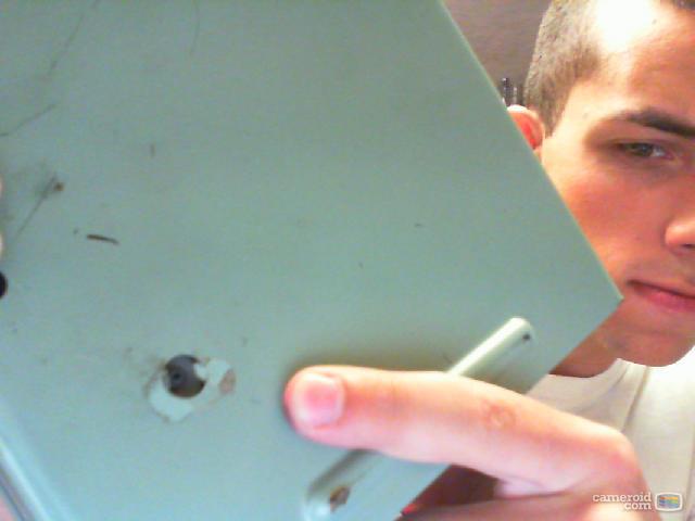

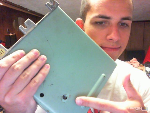

I have this ECU that came out of my 1982 280ZXT and I was wondering what this hole/port thing did.
It looks like a vacuum line might hook up to it or something, but what do I know? ^^
ECU# A18-602 043
Photos of it below!
Thanks, Luke! (:
Attached Thumbnails 280zxt ecu plug?-snapshot-1-.jpg   280zxt ecu plug?-snapshot.jpg
Old May 19, 2013 | 05:41 PM
It doesn't do anything.
Click: XenonS130 - S130 Reference
Are you asking because you are curious, or because you have a problem?

@NismoPick
Because I cant get my car to start! (;
Haha Thanks Nonetheless!

I can't see the pictures - is it a barometric sensor to determine fuel trim for altitude?
