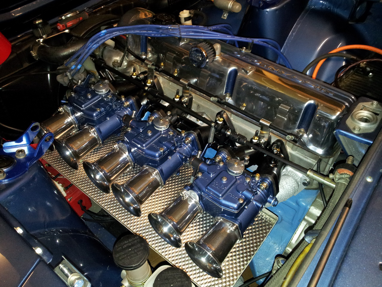

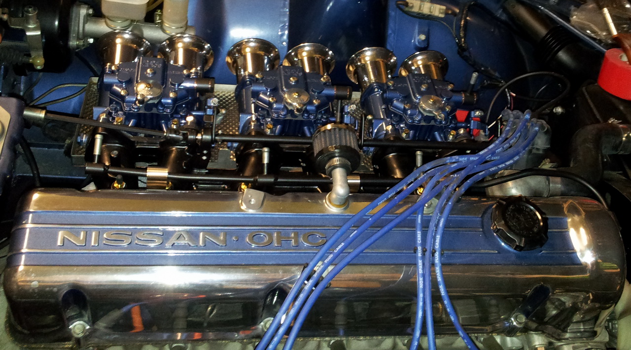

Not sure what you're talking about having to tune triples all the time. I have triple Mikuni 44 PPHs on my 240Z and they are rock solid and I never have to adjust them.
Holly setup on the L28 is meh. Not sure I know anyone who is in love with that setup and it's generally not recomended.
If you want to tune it I recomend getting a turbo dizzy and matching oil pump shaft and at least a Mega Squirt 2 (MS3 has a lot more flexibility but if you're on a budget and not interested in growing to distributorless, etc then MS2 will work). Way cheaper than a set of triple Mikuni's or Webbers (around $1500) but not nearly as sexy.... This is my 240Z triple setup that has been eating all my time. Almost done!

For triples I was referring to webers. I run mikunis on my 76 celica Liftback and have no problems. But I just sold 2 of my 3 sets. Mikunis are harder to come by down here.
That's an awesome looking setup though nis! But this is going to be my daily. And I don't have a lot of money to really build her. I was going with the single holley cause there's a new manifold for $150 and the Carb is not bad. I do love the sounds but im still recovering. From mother project which took me way over on money I didn't have

FricFrac that is one sexy setup, beautiful in every way, adding those pics to my desktop slideshow, did you have the carbs anodized ? Love the color !!!
It's some left over paint from when the original owner painted the car - 2007 Subaru Newport Blue.
