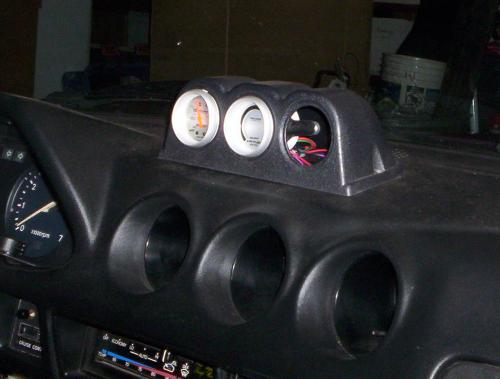

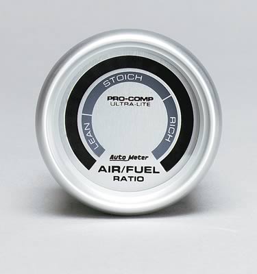

I have the (narrow band single wire) silver face Autometer gauge. It has the flashy lights that go in a circle. Summit Racing part number ATM-4375
Mine stays pretty consistant when the engine is cold but once it warms up it bounces around a bit. Stays in stoich and drops to lean and back quite often. I take it that the drop to lean is just a bad signal. I should take some videos.

you and me got the same thing, different guage face though. its a nice well working gauge, my friend has one in his talon, they dont read for **** unless under a load then they balance out and start to actually read something.
