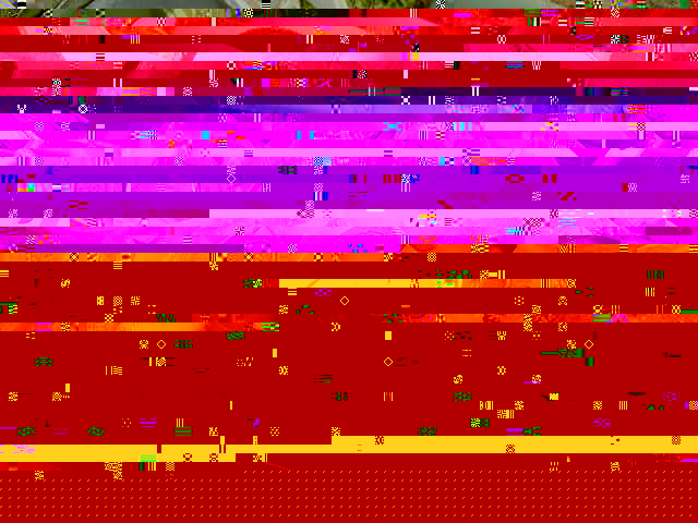

I just dug up a couple old pics of my manifold neck when I bored it... you really shouldn't have any probs if you just bore it to 60mm to match the new TB. I used a carbide barbed bit to carve it out. It's really the only thing that worked... everything else just got gummed up w/ aluminum.
You will also need a spacer, so the throttle arm doesn't whack the #1 manifold runner.
