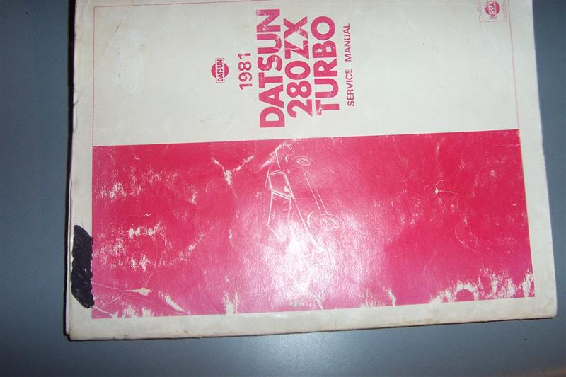

Books before there was the internet....
Well, seek and ye shall find...from the fsm. The location and line drawing of the '81 resistor pack.
thumnails...wish I could upload bigger images. I hope I don't need to add arrows or pointers....look at the eccu's location, just above it.

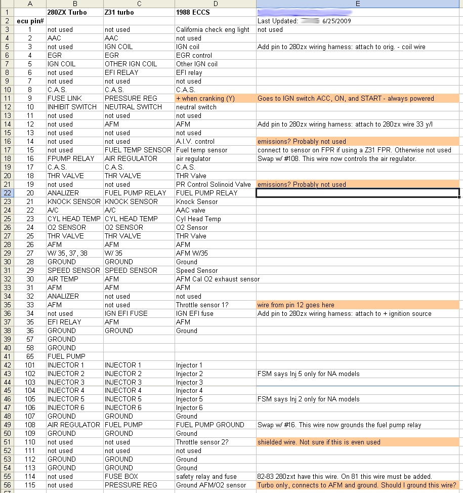

Last summer NismoPick sent me his spreadsheet on the 1984/85 Z31 ecu wiring he had come up with. I went through the 1988 300ZX factory service manual and made my own notes and compared it to the earlier version.
My findings show that the wiring is basically the same aside from the O2 sensor. According to the FSM, #2 and #5 injectors should not be swapped. It specifically says the switch in wiring is for the non-turbo 300ZX only.
"Z31" in the title referrs to NismoPick's contribution on 1985 ecu
"1988" ecu list is my addition
enjoy!
