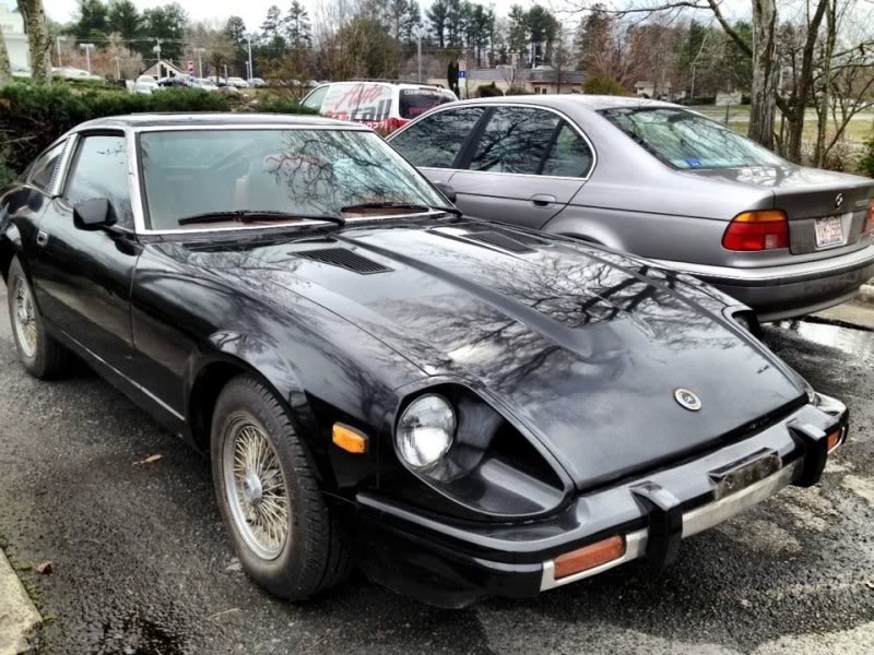

Thought I'd add a picture. Not the best since it was raining and it's just a phone picture.Name:  405944_261486850595343_100002020892297_600234_222534630_n.jpg
looks fantastic!
I wish my paint looked that good! Nice car!
