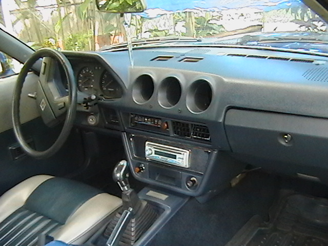

Old Oct 15, 2005 | 09:14 AM
hey efrain... did you know that you don't have to "attach" that pic everytime... you can just put it in ya signature.
Old Oct 15, 2005 | 11:03 AM
efrain's Avatar
Joined: Jun 2005
Posts: 61
I know I just like to change it from time to time. And it would be very helpfull if you can answer the question.
