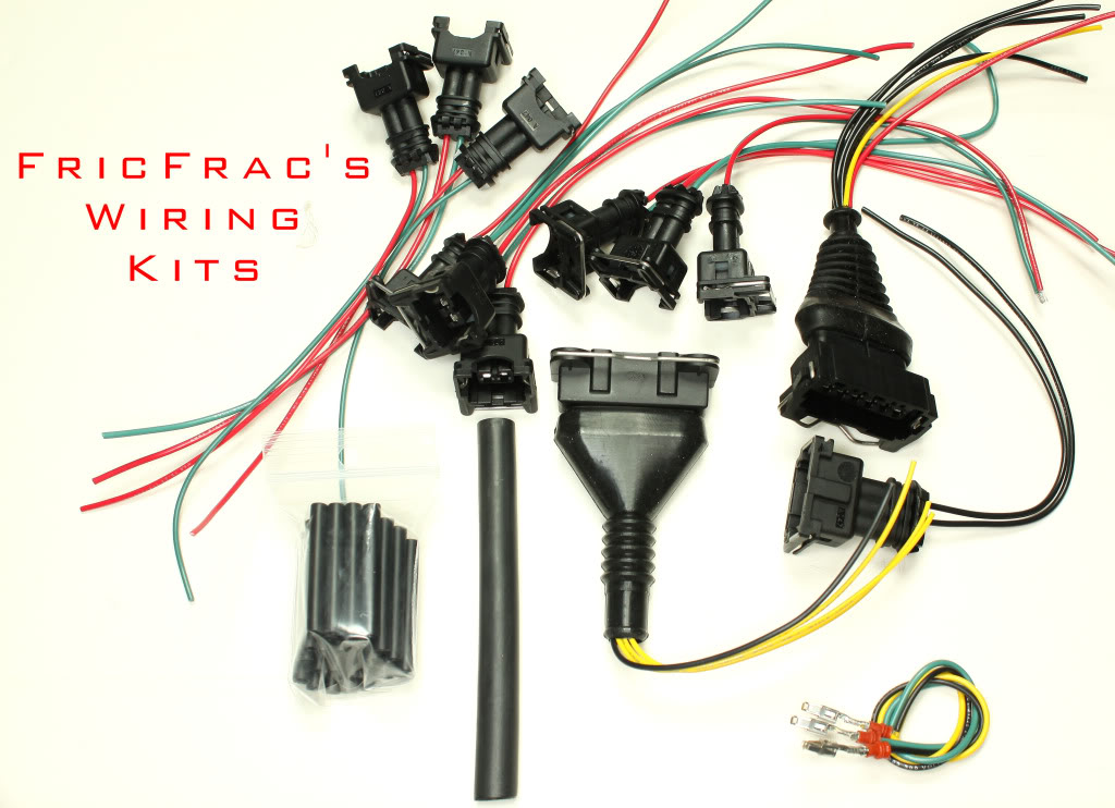

If I recall correctly, the connectors Fricfrac sourced are a major improvement over stock, with nice silicon seals. water penetrating into the connectors and Galvanic corrosion plus the harsh environment a car exists spells disaster for good conductivity, I might be wrong on the type of corrosion, of dissimilar metals, but it needs saying, an upgrade to a superior connector with modern engineering will pay for itself in the long run.
heres a link to his past post with some nice pics of the connectors
https://www.zdriver.com/forums/280zx...remlins-34055/
Old Sep 6, 2012 | 10:08 PM
davidjoe007's Avatar
Joined: Mar 2005
Posts: 181
From: Bay Area
So you're selling this on ebay right? SWEET!!
Yup but it's cheaper through the forum.
