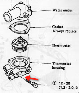

Now, I want to place an analog temp gauge (I've already bought it) but where can I place the sensor (in the coolant house there is one bolt which I can remove but I don't know if that's alright.
Look at the attachment where the arrow is.

that bolt is what holds on the thermostat housing. no coolant passes thru it. you can remove the sensor in the block of 4 facing forward that has a green single wire coming out of it, it should have a male bullet type connector and an inch of wire. that one is your gauge sensor and since you don't need that one, put the new sensor there.

You can do what Shady280 says, just remove the original sensor and place the new with the same spot, and it doesnt affect the ECU. ALSO check for how far deep the sensor goes. My Sunpro sensor went too deep that it was hitting the thermostat from that slot. So I removed the Thermotime switch sensor, with a bigger socket size adapter, in place for the new gauge sensor.

that sensor with the green wire is only for the gauge not the ecu. one of the other 3 is for the ecu. just use a socket to get the sensor out, just use a deep so the wire has a place to go. use teflon tape to seal the threads, its super cheap wherever you buy your sensor from
