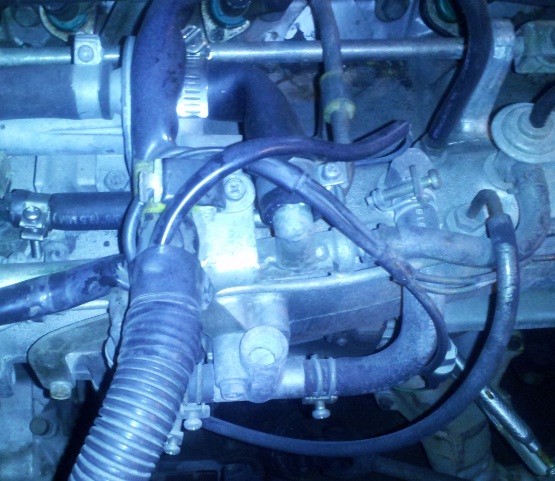

I attached a pic of the hose I mentioned. My last final is tomorrow so I should be able to get in there sunday.
Also easily visible is one of the vice grips currently holding the exhaust manifold on. I've got rusted studs.

Quick update: I got a chance to get under the hood today and checked the spark plugs. They're all firing but the gaps were all too short 34 instead of 44... It wasn't me, I swear! And I got a new hose to fix the one that was crimped, so there's no hindrance on the air flow due to that.
