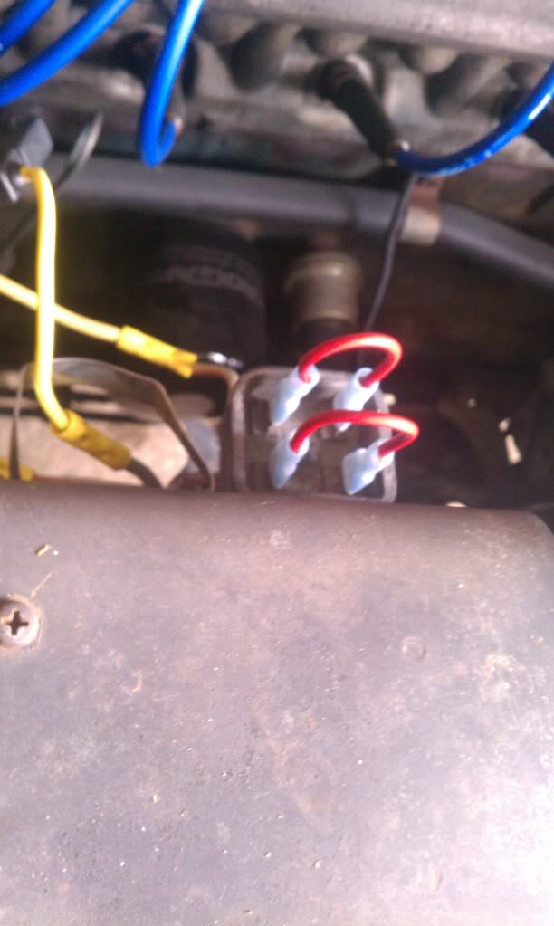

I have replaced and checked the 2 fusible links but it apears to be fine

Think you found your problem.
You should have 4 fusible links in a 78...
It would appear you are missing your third red link (ignition switch) and a black link (Alternator & Ignition Relay)
But it also seems like where your back red link is in your picture, that should actually be a black link, and your box that should have 2 red links is just gone...

The fusible links have been bypassed (yellow wires). It looks like an inline fuse on the one yellow wire. Check that. Download the FSM and start checking for the cause.
