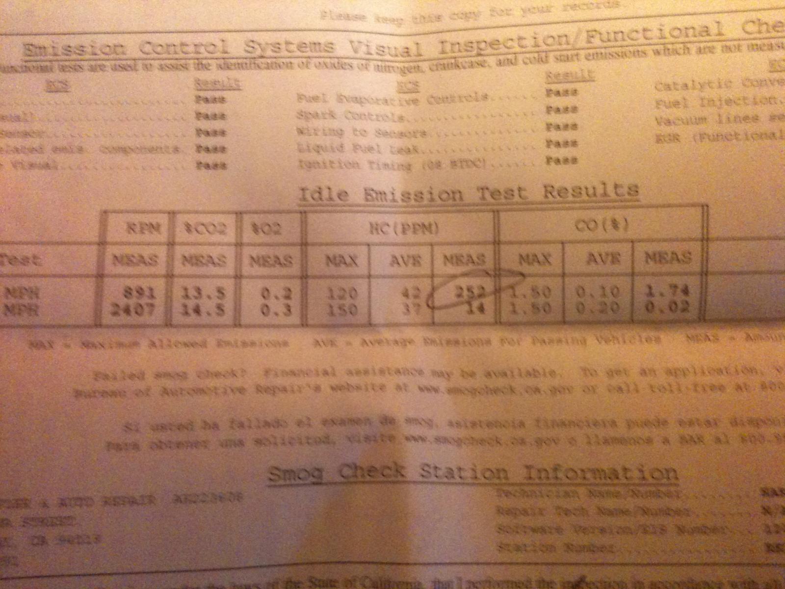

'82 ZX Failed CA Smog Today. Yay.
I apologize for the crappy quality of the pic.
Failed at Idle.
CO is 1.74, max is 1.50
HC is 252, max is 120
Running rich?

Old Mar 3, 2014 | 06:52 PM
Timing too far advanced and/or worn spark plugs.
What... Just replaced spark plugs 2,000 miles ago and timing is at 8 BTDC. Installed a rebuilt dizzy 4-5,000 miles ago as well. I did adjust the AFM 5 teeth CCW shortly after i bought the car because it was running rough at idle, could that be it?

Typically you don't need to adjust the AFM... are you tuning around a bad injector?
Well, when i bought the car i was told that it failed smog on the cars first drive in a year, and that smog tech did something to the the car which corrected the problem. It used to backfire often, and run rough which i replaced sensors here and there and adjusting the afm to the rich side which all corrected the problem. The AFM was being held together by a zip tie, so i knew someone had gone in there before and messed with it.
I just replaced the injectors/hoses/gaskets about 500 miles ago.

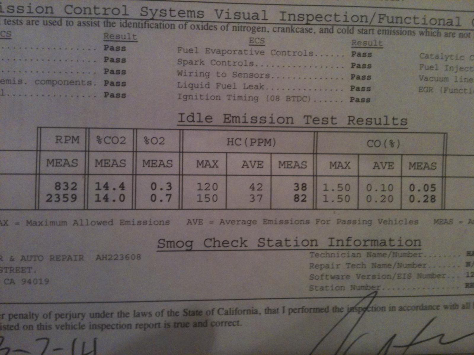

Took a retest after i adjusted the AFM, emmisions are way down now and passed.
