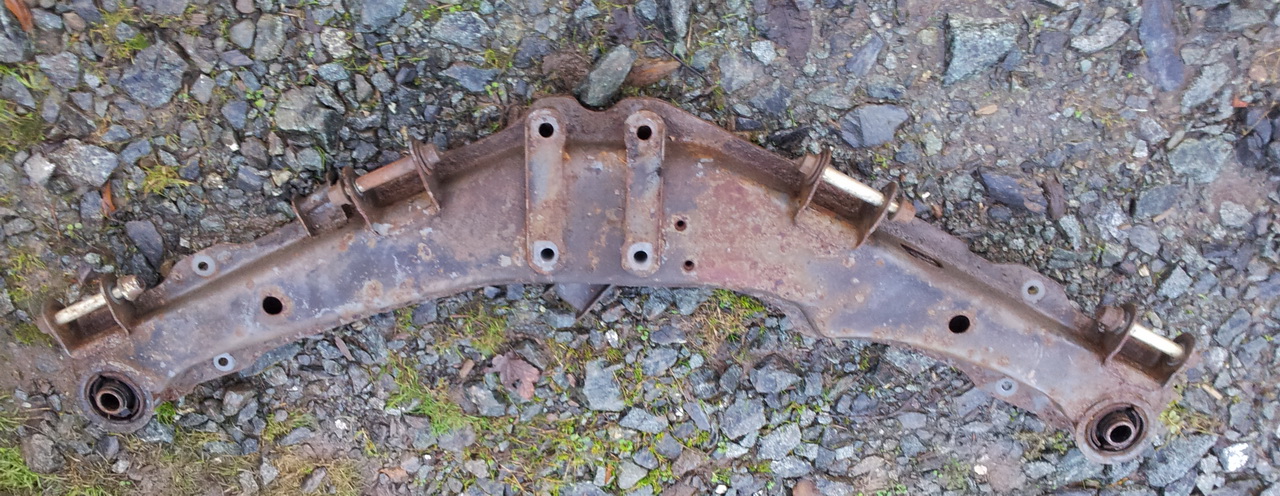

Cross member is out and ready to send to Byron

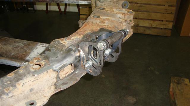

Good news - just got a text that the prototype is done and being welded and test fit on the car this weekend

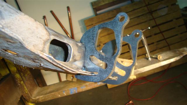

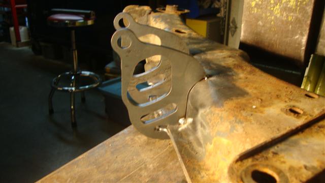

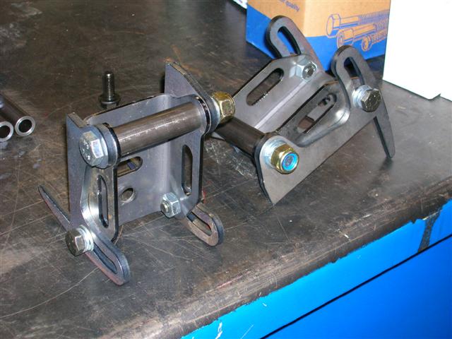

Version one had some clearance issues so we'll be test fitting version two tomorow. Here's a teaser for version two:
