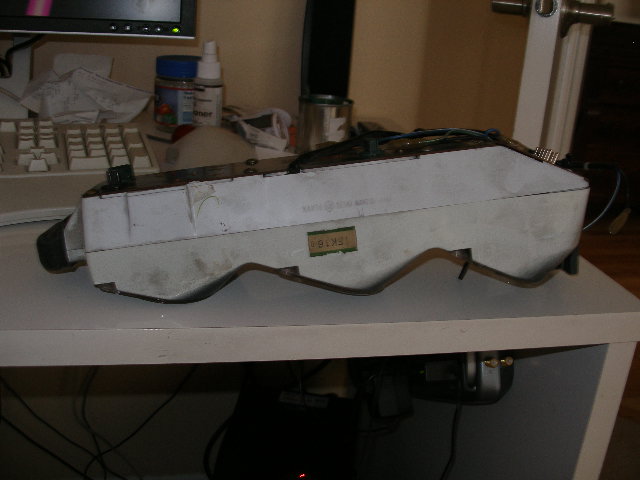

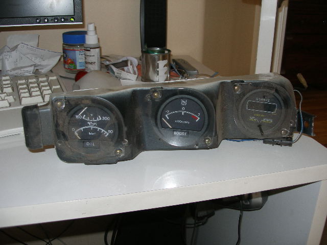

not quite that easy they are all one unit. If you take out the glove box there is a screw (maybe two) and you can slide out the whole unit. after that you need to do some mods to the plastic and then wire up the volt gage. pics are of zxt showing the complete gage module. I don't think pimpshrimp has looked at teh unit very closely

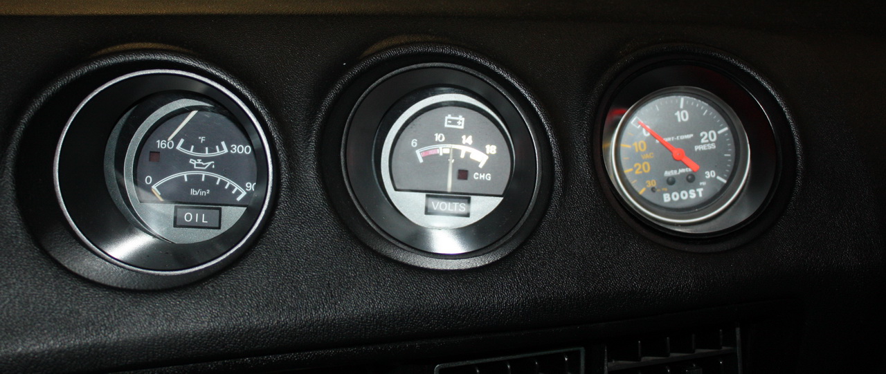

I've swaped gauges around. You're best to replace the stock boost gauge with a real boost gauge. I have the stock oil temp, replaced the stock boost with a volt meter that I calibrated with a power supply and DMM and replaced the digital clock with an Autometer boost gauge.

@fricfrac - I wasn't aware you can move them around that much..i may look at boost gauges as well...i was planning on doing a "a-pillar" mount for the boost gauge but it would be much cleaner in the dash...you wouldn't happen to have a picture would you?

Your gauge looks a bit sideways there!
Old May 21, 2012 | 06:14 PM
From: Victoria, BC
Yea it's the only picture I could find. It doesn't actually look that bad now lol. It just to give you an idea what you can do with the stock gauge cluster with swaping stuff around. Some works some doesn't.
