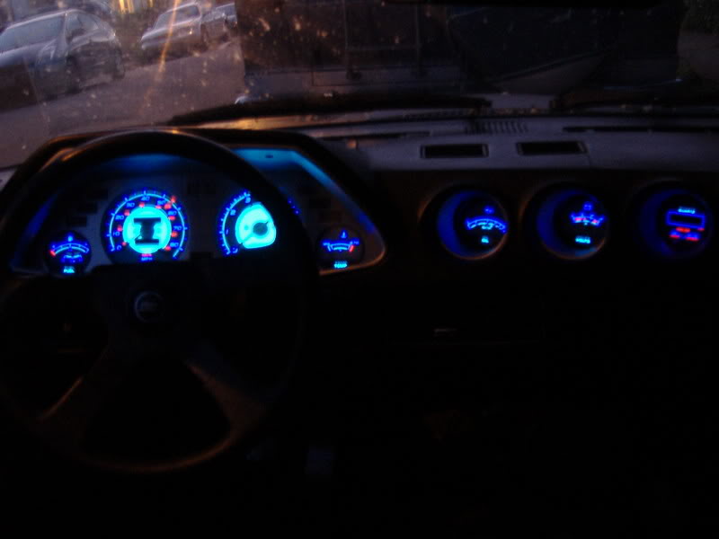

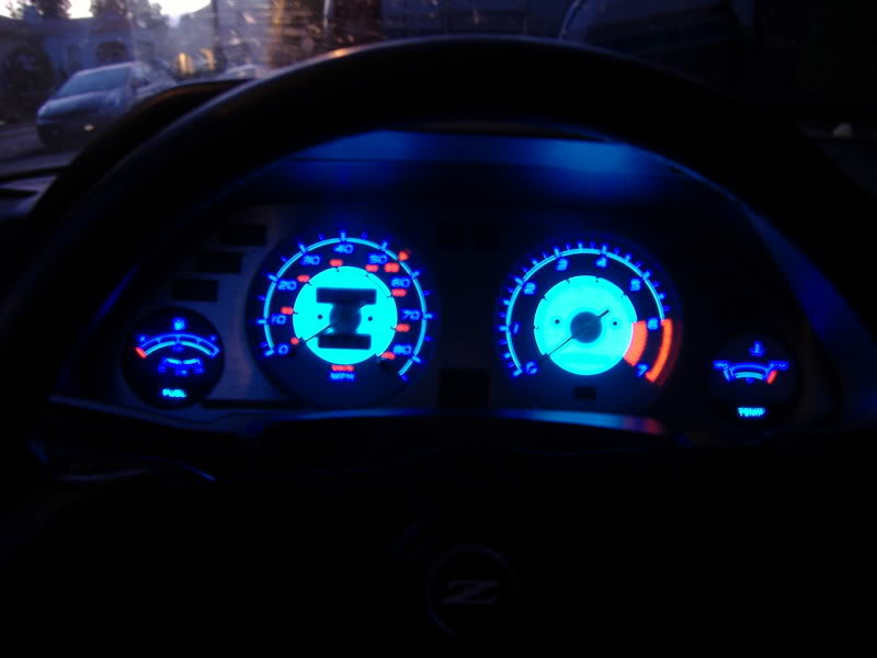

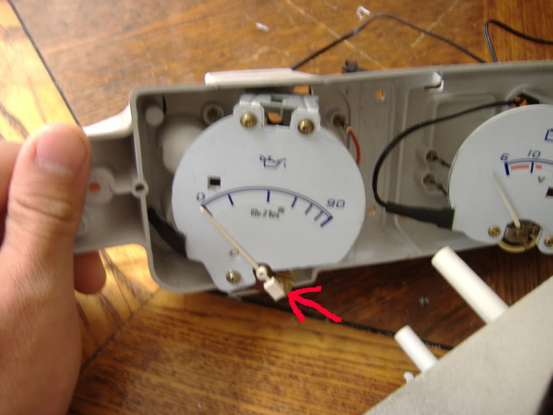

There was a guy who had them on ebay once upon a time but i would not recommend changing the faces with over-lays. Replace the whole gauge with a proper, new white unit. I did it and they lasted all of 3 or 4 months before i went back to stock. Looked like this. . .

But seriously though Bleach. . .dont waste your time with those overlays. Make some money on'm by selling them on ebay or some *****. The clear vinyl cover on the faces started to bubble and warp after a less than warm summer, there were dark and light spots from poor construction and even with a potentiometer they were obnoxiously bright and caused lots of glare in the car during night driving.
They would work if you were going for a lame, showy look like some have done to these cars with accent lights, tvs and useless large scale vinyl decals with accompanying driver costumes. . . .

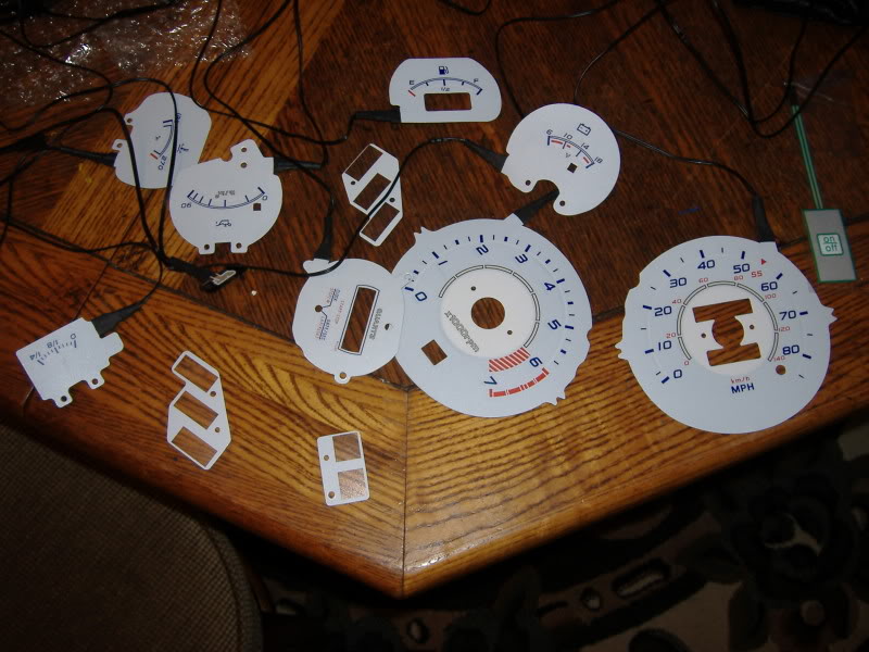

The overlays that Apollo posted have wires and internal lights. They are not stickers.

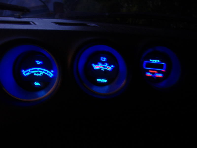

They looked like this before install . . .
