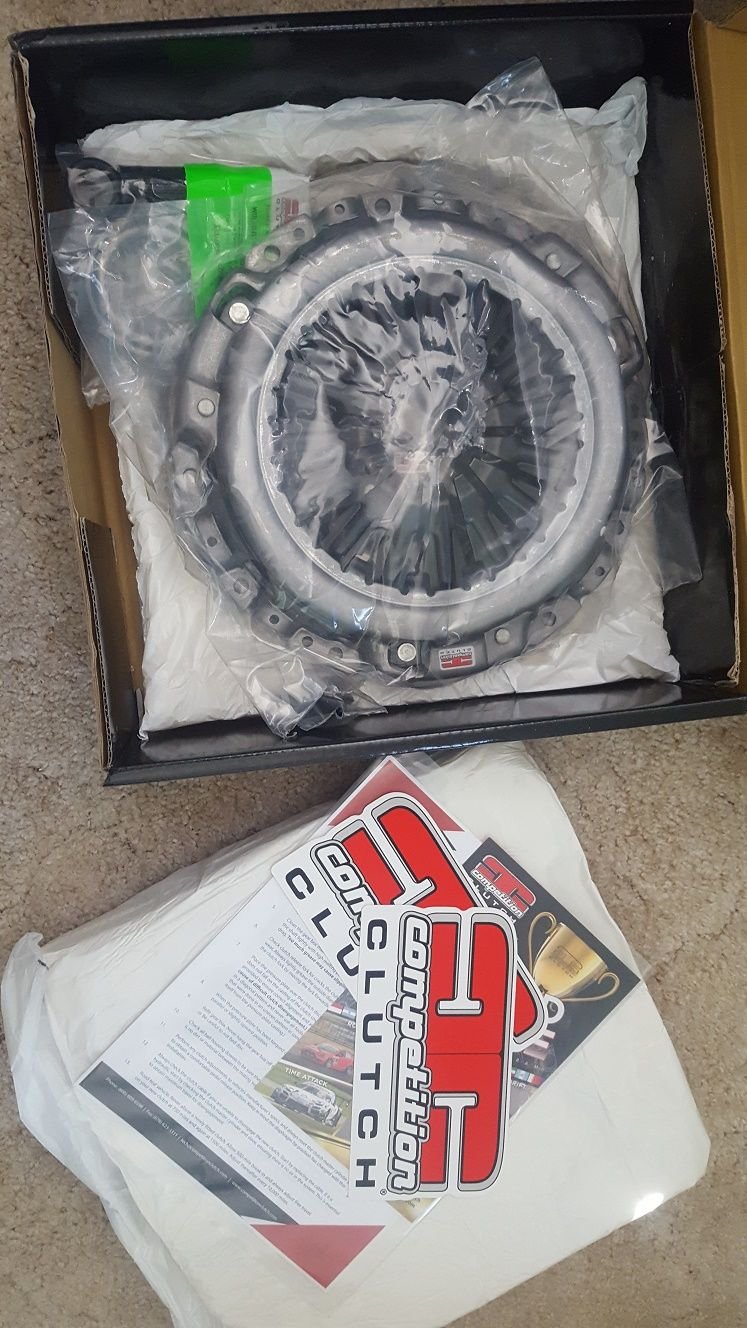

Ok! It's been a while since I did anything, car spent most of the summer on jack stands. Finally had all the bits and pieces to complete everything and its up and running again !!
z32 5 speed is in, with the Hoke adapter.
Parts are here !
Should hold few ponies.
Upgraded clutch fork.

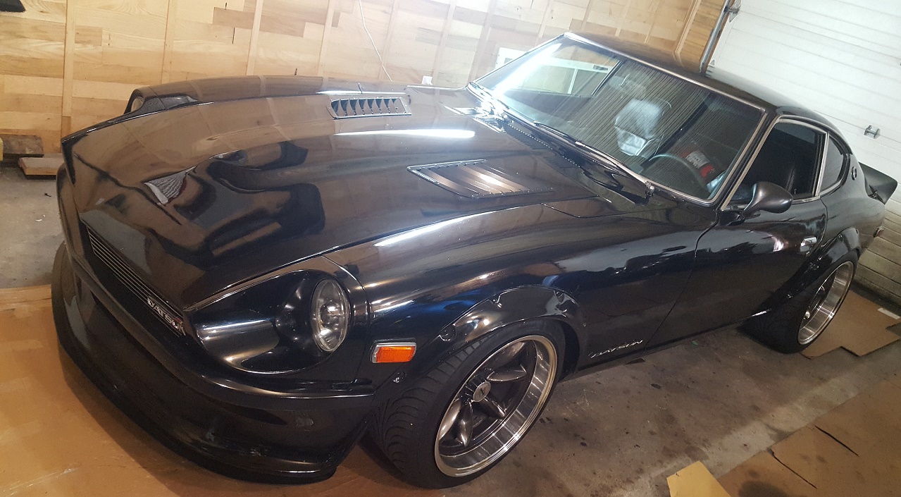

And ...just maybe...
