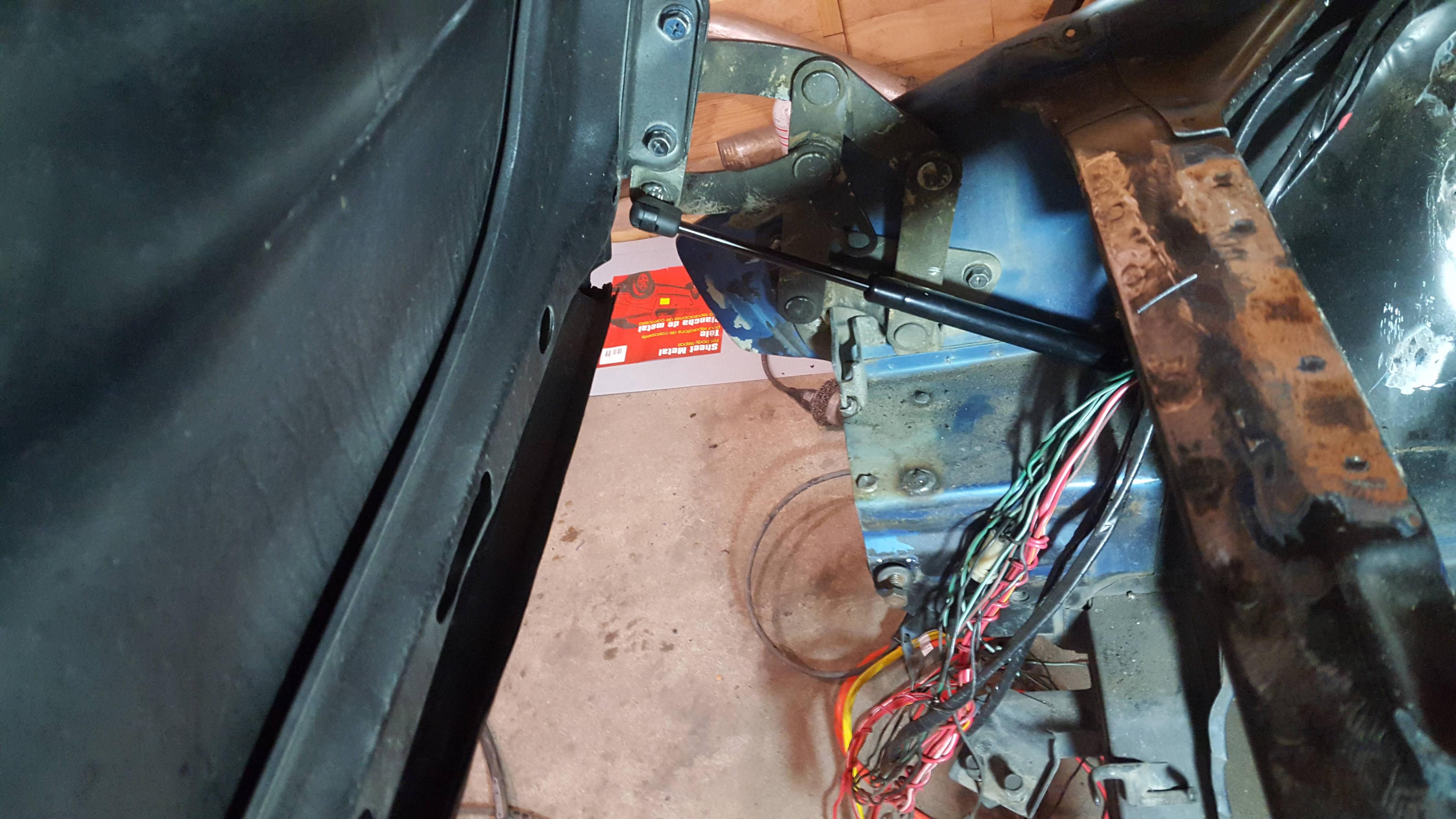

So I did a thing! Wanted to get rid of the spring bars due to inter-cooler, and put gas struts in. Found some cheap ones for 10 bucks a pop, for testing, they are 35lbs or so, 4-3/4 stroke over all length 12-3/4. Just welded the nipple to the hood hinge, the other end is just resting in the corner for now, need to make a little plate and weld it in for the other nipple. Works awesome, the hood stays up by itself half way up, and it opens about 1" short of the original position which is no big deal. I will go up to heavier set of struts and see if the hood mostly opens by itself. Yes I will use a prop rod as well for extra safety.

That's a pretty cool mod Mr. Skully. Getting a little more room up front is going to be very handy. Keep us posted when you go to the different struts.

I saw a set up on eBay for a while but it was over priced. I bought some gas struts at the J yard in hopes of doing something like you have. Can't wait to see yours finished!
This is the one that was on ebay

That's a weird setup he has going, where he drilled to bolt the other end somewhere below looks like it? I think its due to 280z having the front frame extended for the heavy bumpers I get that extra support. I finished welded the 2 other ends, works like a charm! It won't lift the hood up by themselves, but they keep the hood up pretty much from opening to full open, these are 55 lbs struts or something like that, I wouldn't go higher than that. I'm happy with that! This was 20$ and some time.

That nicely balanced hood is better than using stronger struts and having it bust you in the nose when you let it come up.

Yes I wouldn't go with stiffer struts, it would be hard to close, could be twisting the hood as well. The parking brake hooked right up, I think some kits, it doesn't tho. All I had to do is adjust it out pretty much all the way. Works awesome as it is.
