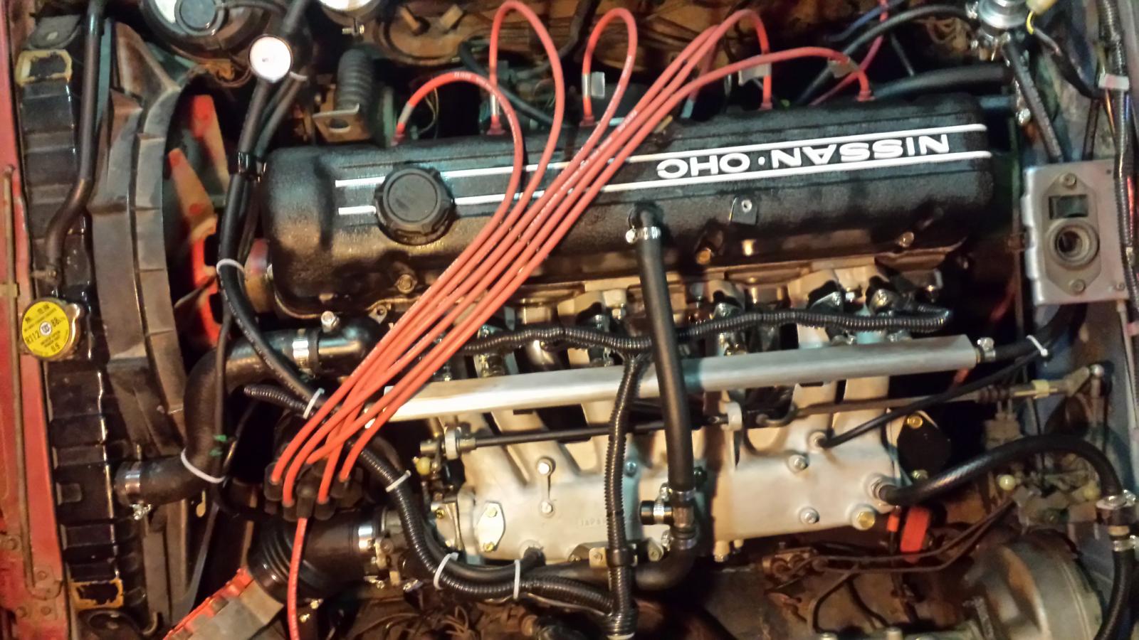

Decided to tidy up the top of the engine a bit. Pretty much got rid of everything up top, threw a fuel rail in, and hid all the wiring under it. Also thew in an aluminum rad I had for over 5 years collecting dust. , Just have to get some FI hose to finish off the plumbing, and throw coolant in.
Enjoy!!

After!

Nice work Skully. I really like that radiator. Will have to consider that.
Having a tidy bay makes it so much simpler to spot problems and get them fixed.
You've reminded me it's time to straighten up my shop area as well. Amazing how quickly things can get disorganized.
Happy Holidays to you too!
