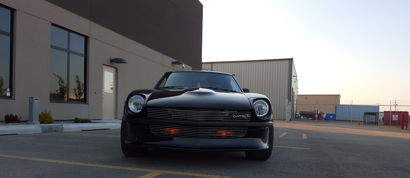

hehe yea its good times! Made a grille out of a mid 80's GMC truck, looks half *** decent.

That is one beautiful car!

Nice! That grill really adds a nice touch to finish the car off. Like the lights behind it. Think I'll copy you on this one!

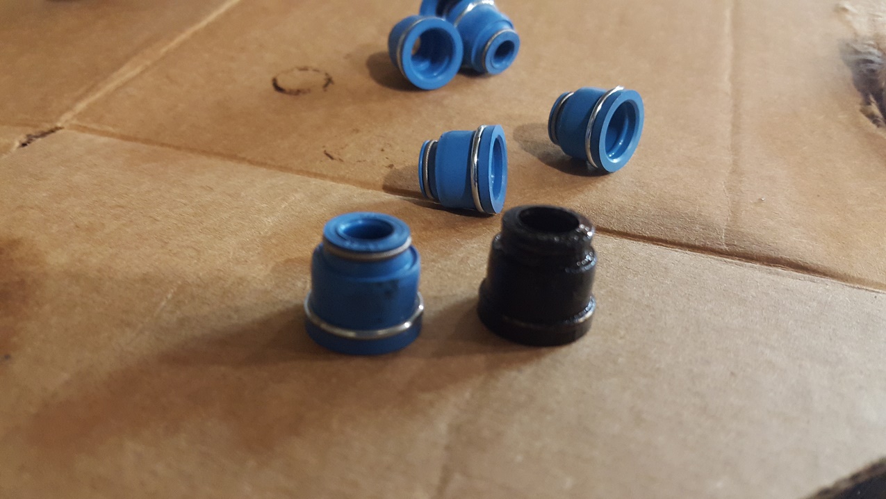

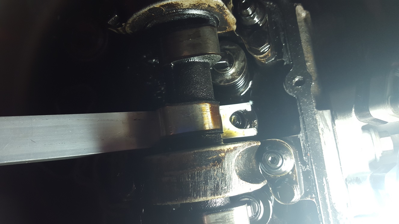

Well, I redid my valve stem seals. The head I have on here wasn't the head I planned to use. I had a rebuilt head long time ago, but the compression was way too high, so its shelved and I found a used head, but I didn't rework it. Maybe I'll rebuild the other motor, and make a high compression carbed, ready to drop in, in case this one blows.
Here is my 10$ valve compressor! lol. It worked, and I wasn't worried about damaging the cam since its aluminum u channel, I drilled an access hole at the end so I can get the magnets in there to pull the keepers out.
edit: If anyone questions their seals, or wants to replace them, this was really easy to do, just have to be careful because of tension and tiny parts could go flying, but its simple, easy way with the head on to replace them!

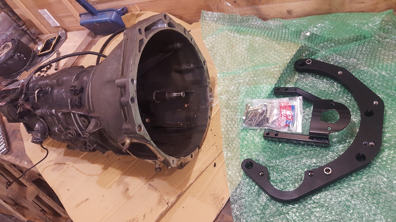

z32 adapter plate, and 5 speed, hopefully going in before winter is done. Gotta get a drive shaft made up. It was -45 or so for a bit there so, yeah no thanks. Its almost 0c now so woohoo, windows open in the house, enjoying the fresh air haha.

Who makes that adaptor? Do you have to change the clutch/flywheel?

There is a few guys that make the adapter, I went with Hoke performance one, since he was making a batch right before new years. Clutch and flywheel remain the same from an L28, there is a lot of writeups on this already, its pretty straight forward, once you get the machining done to the bellhousing.
