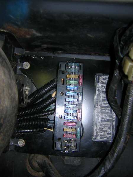

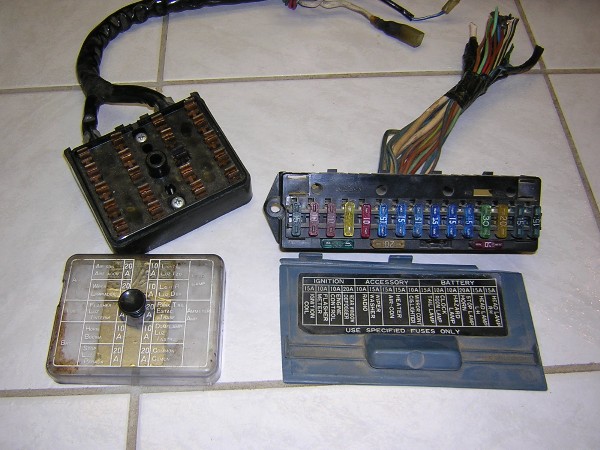

I was thinking back to when I rewired my '70 dash fuse block. I should clarify that the zero reading with the engine off and everything else too. The alt should be putting out more than the demand even at idle if the alt is sized correctly. There is no provision in the early cars to boost the idle for ac.
I took the fuse block from a 180sx and spliced the 240 plugs onto it. It wasn't that hard because the color codes are the same. It also gave me extra ouputs and the blade style fuses.
