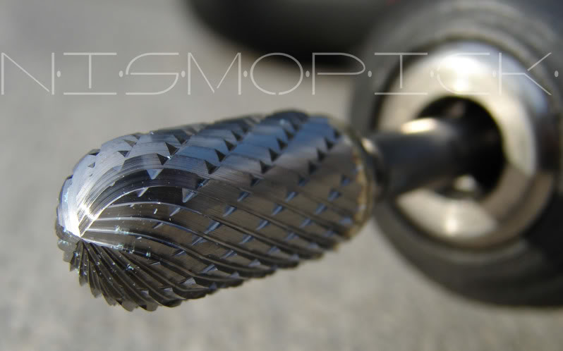

Welcome to ZDriver!
You don't need a new intake manifold... you just need to bore the intake throttle body neck. We've discussed many times. Also (just an FYI since you've already bought the MSA TB) you can easily adapt the KA24DE / SR20DE 60mm throttle body to the L28 intake neck. They are plentiful in junk yards and can be had for $$free99 to around $30.
For the n/a, a 60mm TB doesn't do much by itself since you are just pushing around the bottleneck. You should also swap AFM guts for the larger turbo AFM body.
