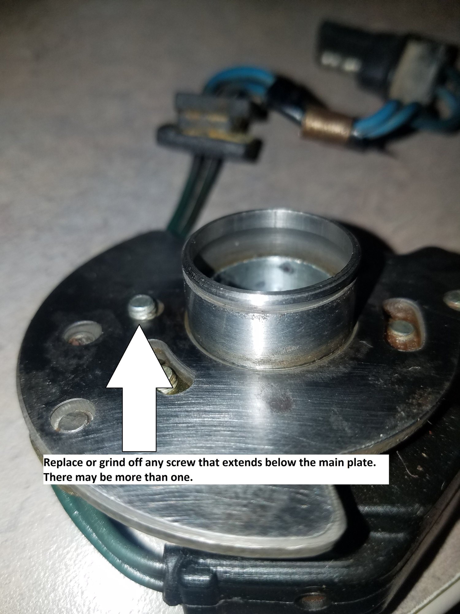

With the new updated design of the bearing retainer, a small modification will have to be made on one or two of the breaker plate screws. Once you have taken the breaker plate apart to verify that you need a new bearing retainer take a look at the bottom of the top half of the plate. Any screw that extends below the surface will have to be ground down. You can see in my pictures the one screw that I did grind down. If you don’t want to do any grinding you can always source out a new shorter screw or two, your choice. I do have a 1978 dual electronic pickup distributor that has 2 screws that extend below the bottom of the top plate. Other than that, just pay attention to how the plate is assembled when you take it apart.

Here is the screw that I had to grind or replace. There may be more than one.

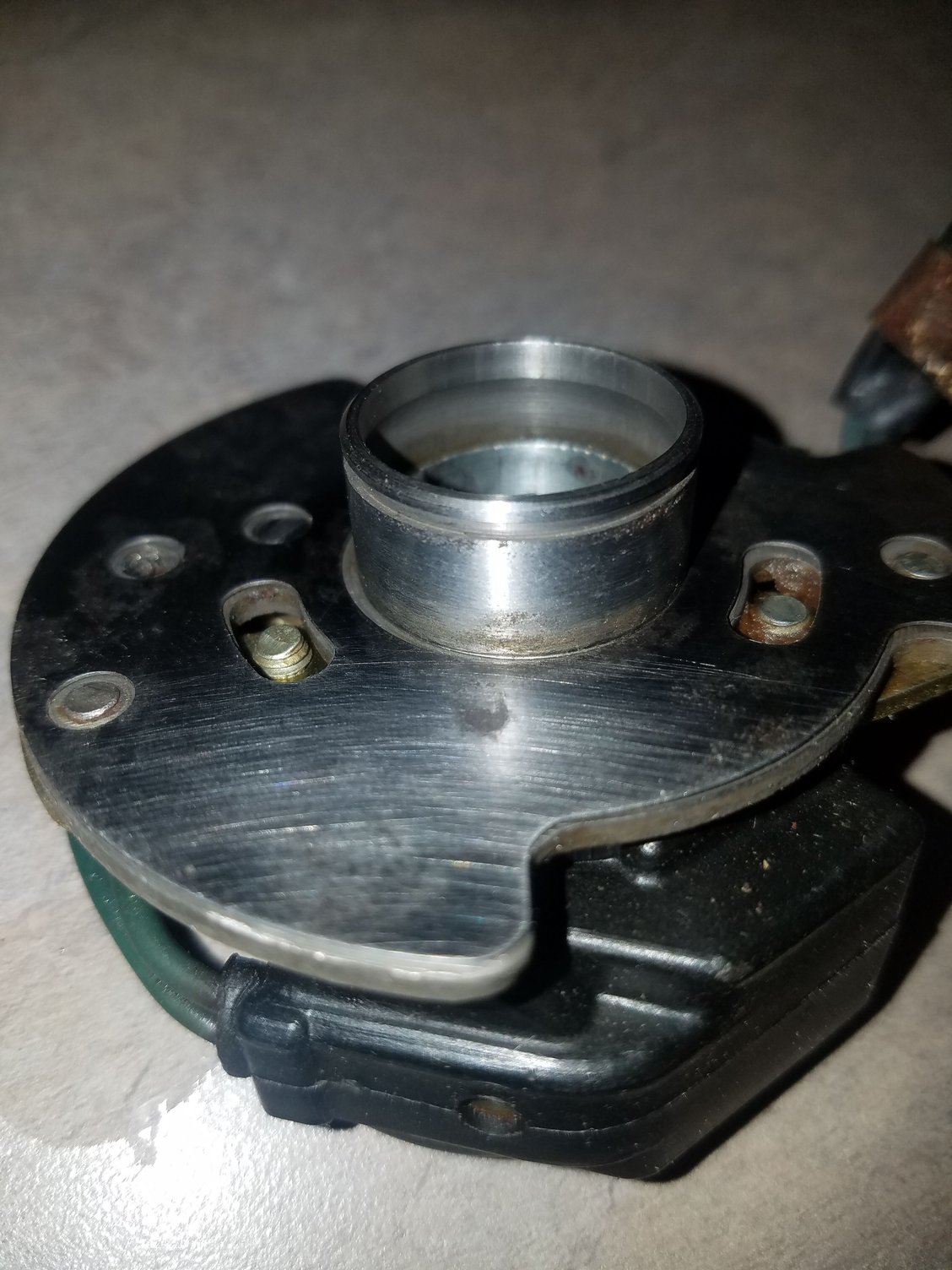

Nothing can extend below the bottom of the plate or interference will occur between the screw and then bearing retainer. The bottom of the plate needs to look like this.
