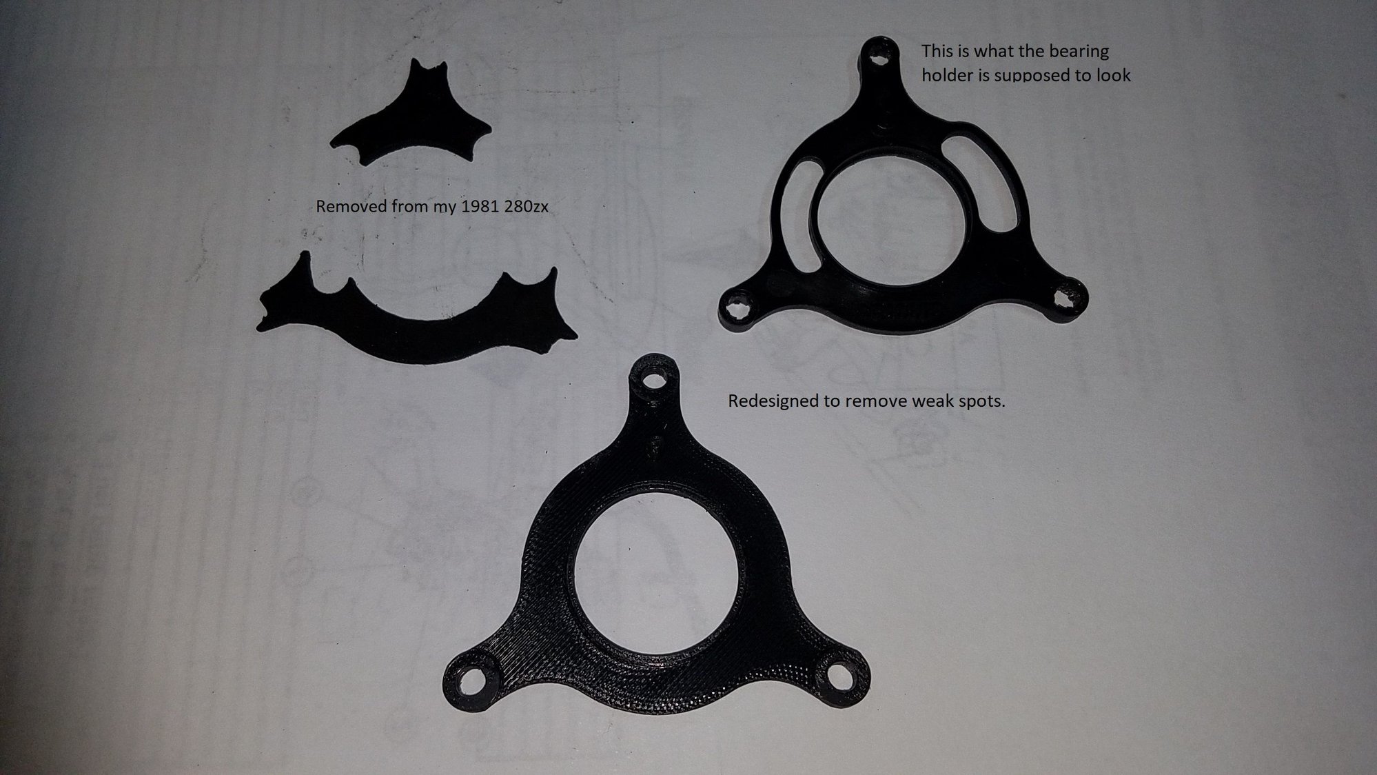

During the rebuild I cleaned/sand blasted everything I could and repainted everything. When I was taking the distributor apart for sand blasting, I discovered 3 small ***** and some plastic in the bottom of the housing. After some research I discovered that the ***** are the bearings that the breaker plate rotates on when the vacuum advance changes the timing during normal driving. The plastic bearing holder falls apart after so many years of heat. Guess what, the plastic part was never offered as a replacement part. An entire breaker plate assembly had to be purchased. Breaker plate assemblies are no longer available from Nissan and are impossible to find.
So here is where my OCD kicks in. I was able to obtain a rebuilt distributor from an online source and took the breaker plate assembly out and disassembled the breaker plate assembly. I took the plastic bearing holder and sent it to an engineering firm that specializes is plastic molding/printing and had them redesign/reinforce the weak spots in the bearing holder and I have had a small batch of them produced. I have sourced proper size replacement bearings and I have even found a small stash of pickup coil magnets! These also have a tendency to break and fall apart.
25.00 for the bearing holder and 3 new bearings
price includes shipping
I will be posting an ad in the parts for sale as. I know that I am not going to get rich selling these, but I would like to re-coupe my investment and help other Z fans. The vacuum advance is not a start/no-start kind of part, but does make your engine run much better at partial throttle and better acceleration at part throttle.
