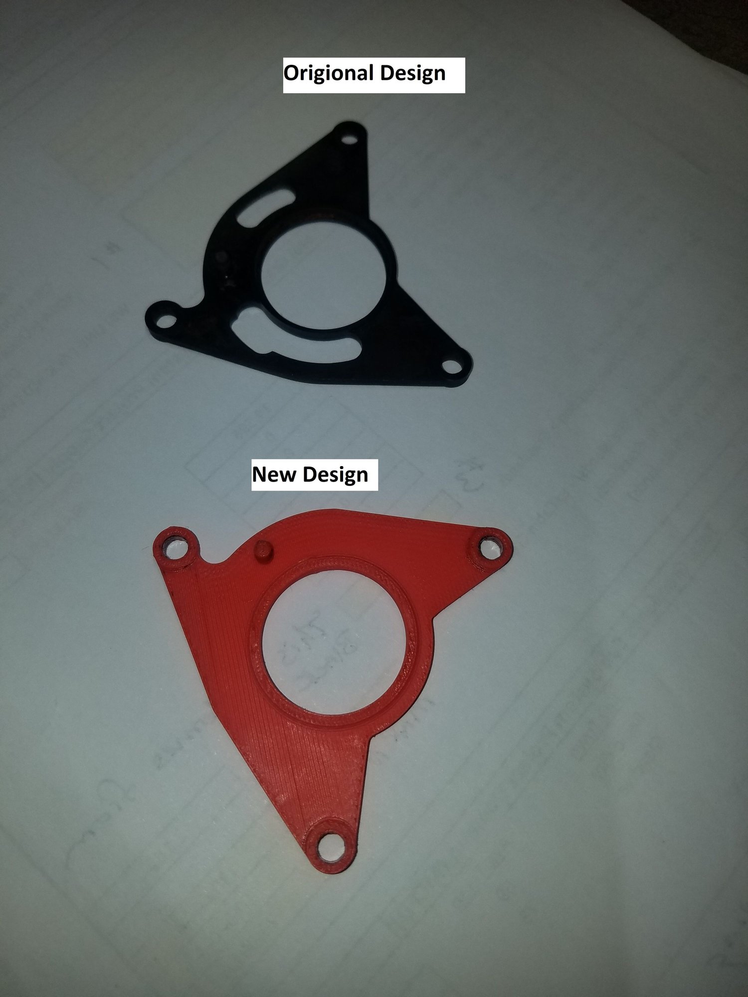

Greeting all. After several inquiries about using my current breaker plate rebuild kit for 1979 to 1983 cars on pre-1979 cars, I reassembled my design team and have come up with a better design for the plastic bearing retainer that is found in the Datsun 260z and 280z distributors from 1974 to 1978. The earliest distributor I have is a 1974 and it is an electronic pickup distributor. I do not own a pre-1979 Datsun car or truck but I have picked up extra distributors as I find them in my local scrap yard. I DO NOT know when Datsun changed from points to electronic pickup in their distributors but since I have a 1974 Datsun 260z distributor, I assume that all 1974 260z cars are electronic pickup, but I may be wrong. So, what I do know is that my bearing retainer will fit ELECTRONIC pickup Datsun 260z and 280z distributors from 1974 to 1978. As I find out more, I will update the post.

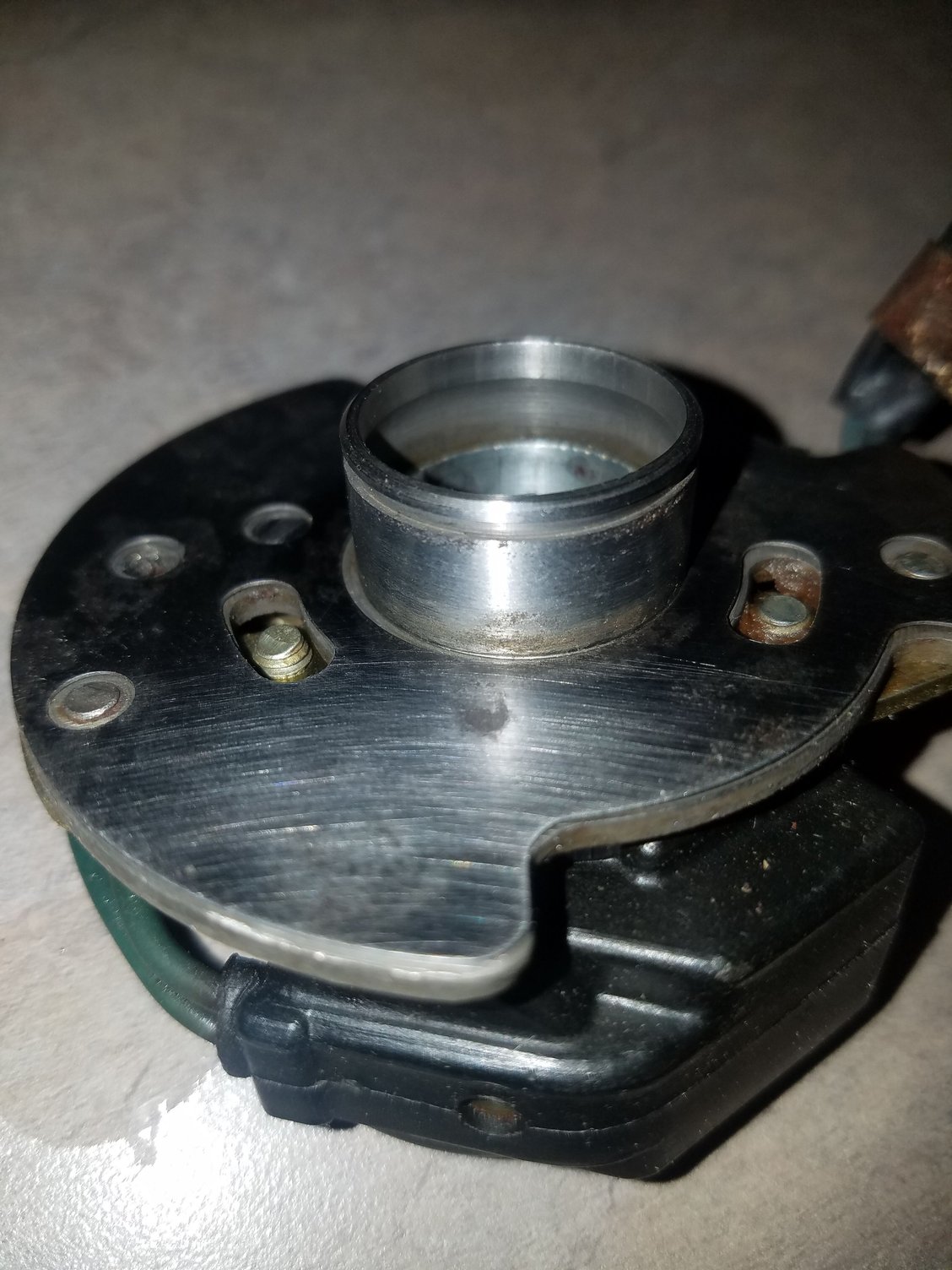

With the new updated design of the bearing retainer, a small modification will have to be made on one or two of the breaker plate screws. Once you have taken the breaker plate apart to verify that you need a new bearing retainer take a look at the bottom of the top half of the plate. Any screw that extends below the surface will have to be ground down. You can see in my pictures the one screw that I did grind down. If you don’t want to do any grinding you can always source out a new shorter screw or two, your choice. I do have a 1978 dual electronic pickup distributor that has 2 screws that extend below the bottom of the top plate. Other than that, just pay attention to how the plate is assembled when you take it apart.

This retainer is made out of the exact same hi-temp ABS that is used on my 79-83 retainer but I used red to tell them apart.
Here is the screw that I had to grind off or replace. There may be more than one.
There needs to be nothing extending past the bottom of the plate to avoid interference with the new design bearing retainer.
