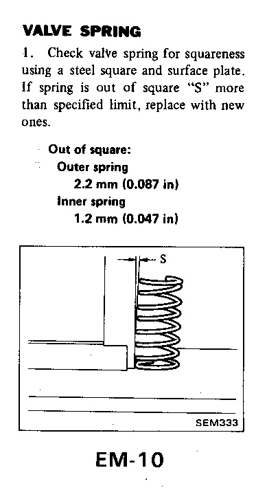

So here is another question, now it is possible I just never paid any attention the the valve springs in any other heads of mine and they were all like this, but I coulda SWORE they were all single spring. But the P90 I have is a double spring setup... this standard? lol. speaking of which got the head back
They all have 2 springs (inner & outer):

Also, BAHAHAHAHA at me for never ever realizing there has always been an inner and outer spring on every Z I've owned and motor I have torn into...
