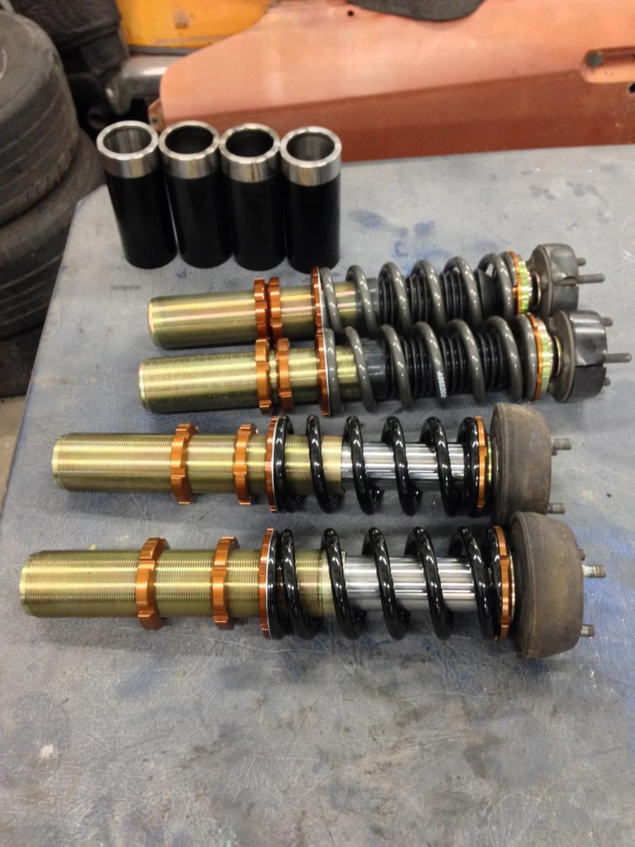

Finally, the last setup that probably no one else has is mine. I just had my coilovers installed. Its a new setup that was put together at Sakura Garage here in Tempe, AZ. It was put together all from Stance Suspension, they make a lot of stuff for 240sx and what not. Greg, the owner, basically measured everything up and decided to make his own set up. It retails for $1500 and comes ready for you to weld to spindles.
